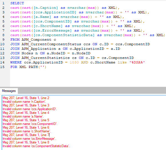

For me problem is to wrap it into XML PATH, there are a lot of "Invalid column name" errors in the DB manager, obviously I did something wrong:

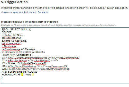

Anyway, after simulation, SW shows me another error: "MACRO SQL ERROR - Incorrect syntax near ')'", don't even know why, I use this code:
${SQL: SELECT ISNULL((
SELECT
n.Caption AS Node,
ccs.ApplicationID,
a.Name AS AppName,
ccs.ComponentID,
c.ShortName,
cs.ErrorMessage AS Message,
cs.ComponentStatisticData AS Statistic
FROM APM_Component c
JOIN APM_CurrentComponentStatus ccs ON c.ID = ccs.ComponentID
JOIN APM_Application a ON c.ApplicationID = a.ID
JOIN Nodes n ON a.NodeID = n.NodeID
JOIN APM_CurrentStatistics cs ON c.ID = cs.ComponentID
WHERE ccs.ApplicationID = ${N=SwisEntity;M=ApplicationID}
AND c.ShortName like '%DSA%'
FOR XML PATH('')),'None')}

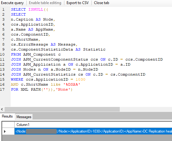

Same code works fine in the DB Manager:
Could you help me please?
