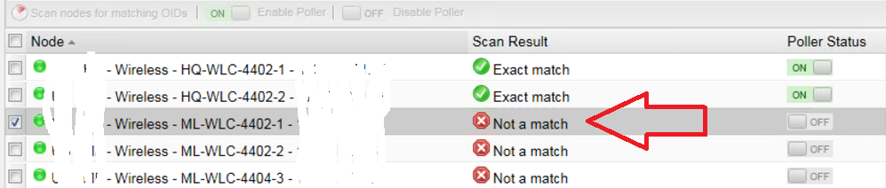

See below screenshots for an example.

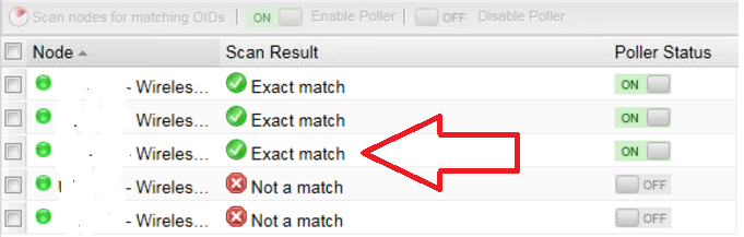

Here is the "Routing" poller exhibiting the behaviour I mentioned in my post above:
Notice it says Not a Match here?

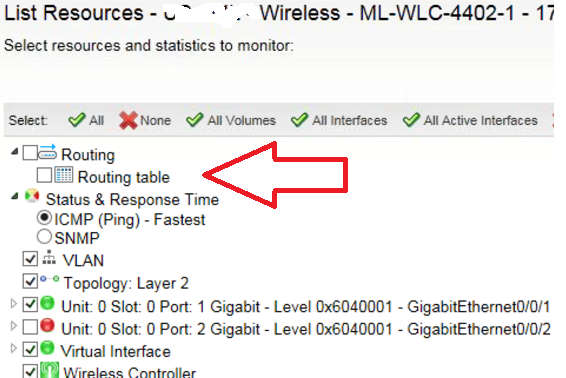

Now I do a List Resources on that exact node, and lo and behold! Routing is available:
I selected "Routing" in the List Resources of that node, then bo back to Manage Pollers and refresh the screen and what do you know, it was actually an Exact match all along:
