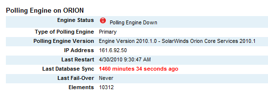

Has anyone found a method to setting up a notification or alert if one of your polling engines are offline? Recently I discovered just through pure accident one of my polling engines was offline. I have 2 polling engines setup, after reviewing the status the error stated that the database hadn't synced in nearly 5000 minutes, so I went nearly 4 days without a SNMP poller and no indicator that there was a problem. I played around with some SQL on the advanced alert mgr. but I can't get it figured out. Just a email notification or something like that would work should one of my polling engines be unavailable. This is from another post that is unanswered and is the same error I had just a longer duration:
