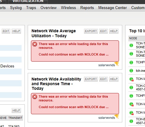

The other day, I noticed that when I logged onto a particular Orion user account I saw the following error. The page will refresh fine but the error still exists. Anyone have any ideas?
Looks like an issue pulling the SQL for the resource. Is there anyway to click on the error message to get the full error? If not, I would turn on hubble for the website. This will allow you to see what the website is calling and should be able to show you the full error. If you are on 10.3.1 or later, just go into Start > All Programs > SolarWinds Orion > documentation and support > open the LogAdjuster and enabled hubble then reload the page. Once it reloads you'll see a red box at the top. Click on Details and you can sort for errors and see if you see the same error.

Thanks, I will enable Hubble. I also noticed that we are very very low on disk space on the main drive. Something is eating it up every time I delete unnecessary files. Could low disk space possibly cause this problem? FYI, we are running two physical servers. One server is the DB server.
Sounds like log files backing up because of all the errors the site is generating. knows the SW software like no other. He may be able to chime in on this as well.
It's either going to be log files that may still be in Debug (check the log adjuster for that) or if you have any reports scheduled to send PDF report, then a copy of that PDF ends up being saved locally on the server.
