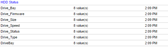

I'm trying to monitor the status of hardware on some HP servers. I've found these pollers: HP Proliant Server Custom Pollers and was able to get the pollers set up. It's not easy to actually view them as the Current Poller Status apparently has too many statuses to show

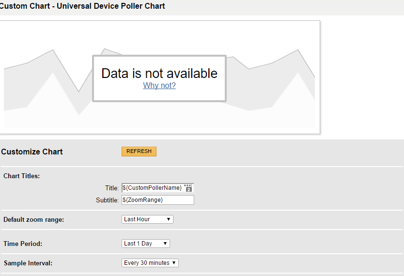

And then clicking on the Drive_Status can't be displayed the way it wants to:

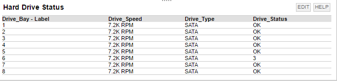

I'd like to be able to more easily view that status, but even without, it does appear that it is pulling legitimate data, so all I really need is a way to alert off of the poller status.

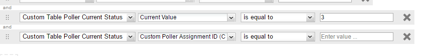

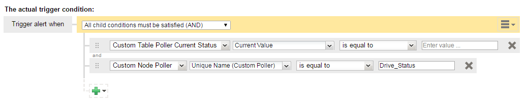

My problem is when I go to add new alert, I can't seem to find a way to actually check for the appropriate values. I found the Custom Poller ID by grabbing it from the URL when I'm on the page that I took the screenshot above from. I've also found that I can use the Custom Node Poller Unique Name. That part appears to be working because if I only check for only that, then it would generate 1 alert (I only have the poller on one server currently). If I try to add an AND for the Custom Node Poller Current Value I don't seem to be getting the right kind of info, so I feel like that is not the correct way of querying. The only listed values it shows are numbers. The poller itself lists current status as OK. I tried using that as a value anyway, but I get no matches, which indicates that I don't have it put in correctly. Anyone know how one might implement this? I'm also looking to use some variables in the alert about poller information, but my first step is to properly configure the alert. Any help is appreciated. Thanks!
