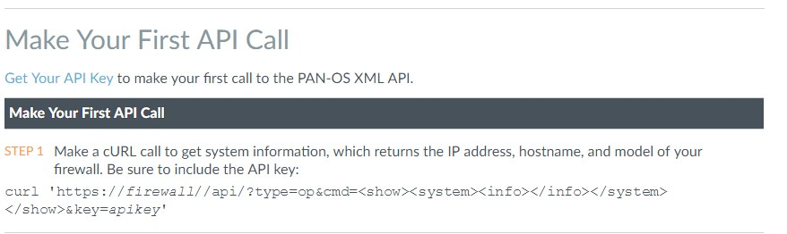

Start on this page: Get Started with the PAN-OS XML API
You can construct a query that looks like this:
https://firewall.foobar.com/api/?type=op&cmd=<show><routing><protocol><bgp><peer><virtual-router>[virtual router name]%3C%2Fvirtual-router%3E%3C%2Fpeer%3E%3C%2Fbgp%3E%3C%2Fprotocol%3E%3C%2Frouting%3E%3C%2Fshow%3E&key=[account api key]
