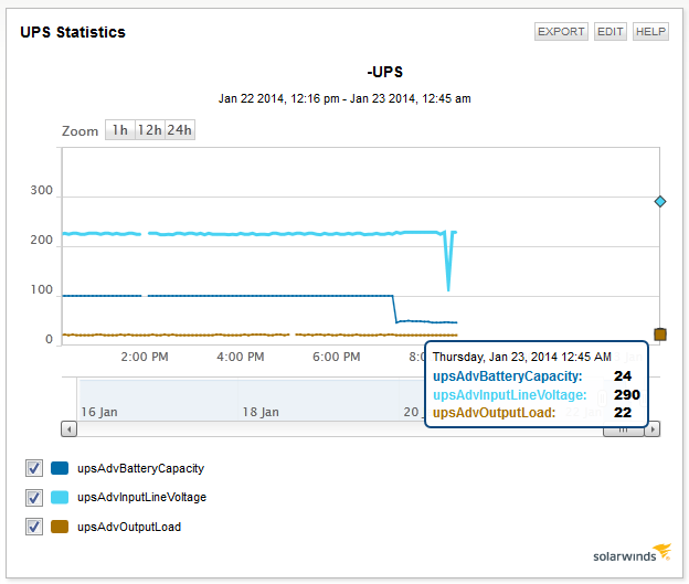

Sympton: UnDP Chart stopped displaying data.
Cause: UnDP historical data "got unchecked", it had stopped collecting after SolarWinds Tech Support ran the configuration wizard earlier this afternoon.
Fix: had to re-enable "Keep Historical Data", lost hours of data.
