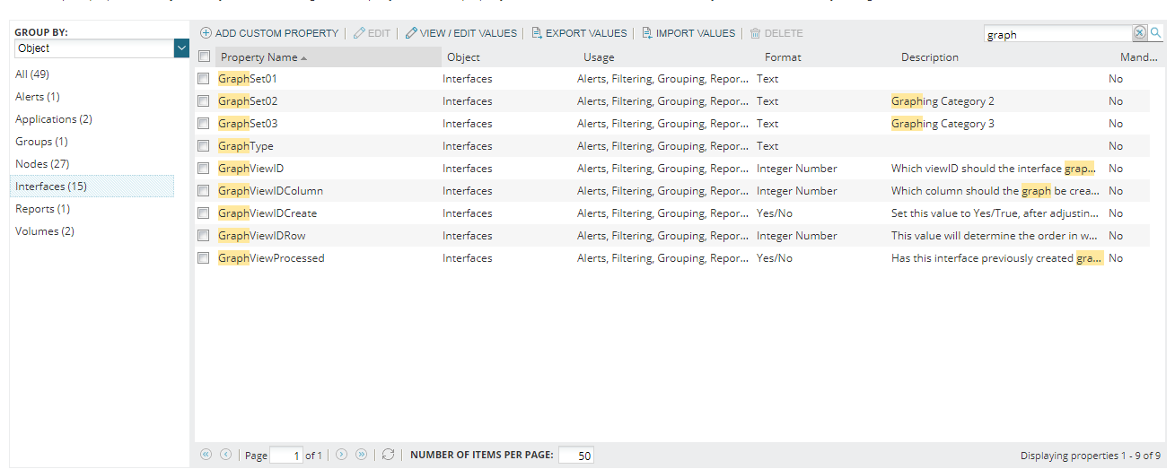

Custom Properties:
You must create the following interface custom properties:
GraphType Text
GraphViewID Integer Number
GraphViewIDColumn Integer Number
GraphViewIDCreate Yes/No
GraphViewIDRow Integer Number
GraphViewProcessed Yes/No
Setting "GraphType" to use a drop down select box, add the following values as options to select:

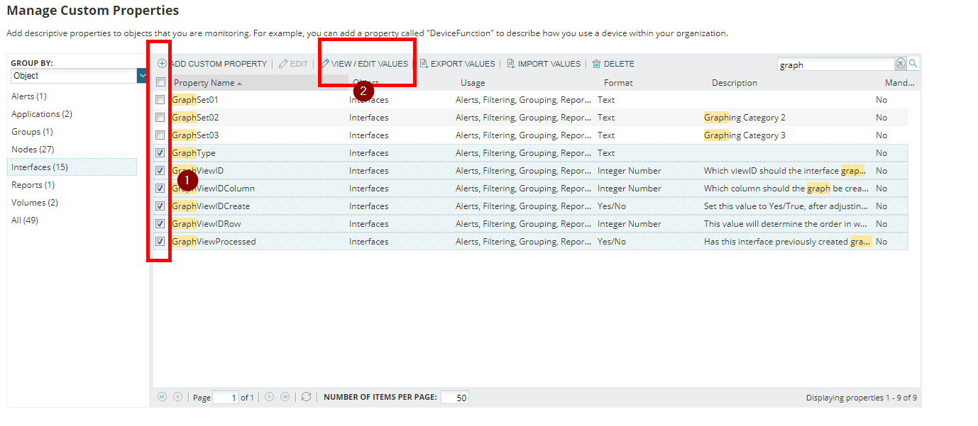

Now that you're on the Manage Custom Properties page, group by Object, select Interfaces, and select the "Graph*" properties we need to work with.
You can jump directly to the Custom Property Editor, /Orion/Admin/CPE/InlineEditor.aspx, however, I find going through the manage CP page helpful, as it is a quicker way to add the CPs we need to work with.

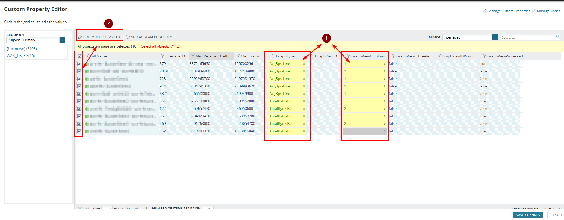

Clicking the View/Edit Values button will take you to the Custom Property Editor page, which we will use to select multiple interfaces at once, and set all of our graph settings.
From here, we can set which type of graph we want to create for each interface, as well as determine the column in which the graph will be created. (For this example, our alert will not accept the row value, however, it is easy to add and works pretty well.)
To keep it simple, I have selected 10 different interfaces, adding 5 as "AvgBps-Line" graphs, to column 1, and the other 5 as "TotalBytesBar" to column 2.
Now it's time to activate the script. Select all, then click on "Edit Multiple Values".
Since all interfaces already have the graphtype and columns set, all we need to do now is tell it which view we want to build on, and then trigger the alert/script.
In this example, I have created a new "Summary" view, and I know the viewID for that view is 141.
So, I put 141 as the value for the "GraphViewID" CP, set the GraphViewIDCreate value to "True", and make sure the "GraphViewProcessed" value is set to "False".
Once those values are correct, click "Save Changes", which should trigger our alert/script.

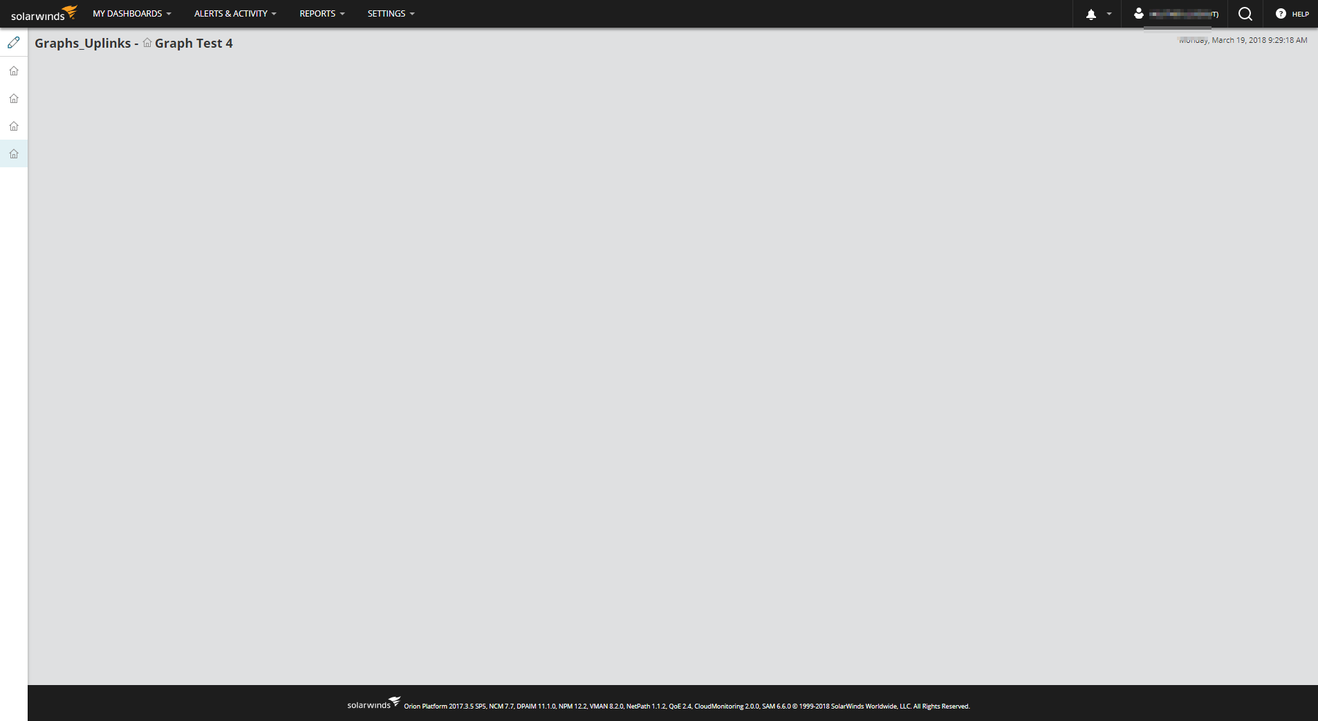

Here is our page (ViewID=141), before:

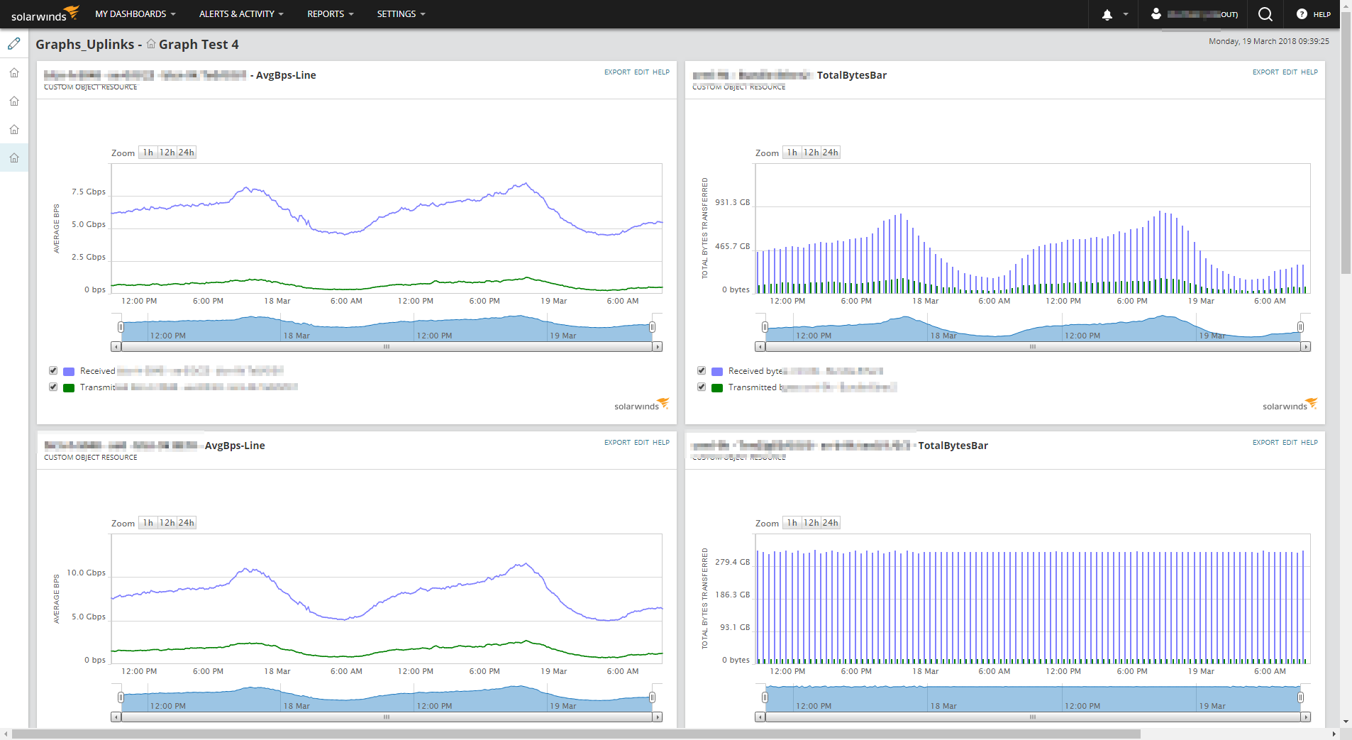

And here is our page a minute or so after we submitted those custom property changes to the interfaces. (While this screenshot only shows 4 graphs, out of the 10 we wanted, the remaining 6 graphs are certainly there.)
A nice feature here, is the script is configured to pull the "StatCollection" interval for each interface, and configure the corresponding graph to sample at the same interval. So if you have a handful of interfaces, each with different polling cycles/intervals, the sample rates of each graph will be adjusted to reflect the interval of each interface. (This only applies at the time of creation. If you change the interval after creating the graph, you will need to recreate the graph, or manually update the graph sample rate.)
