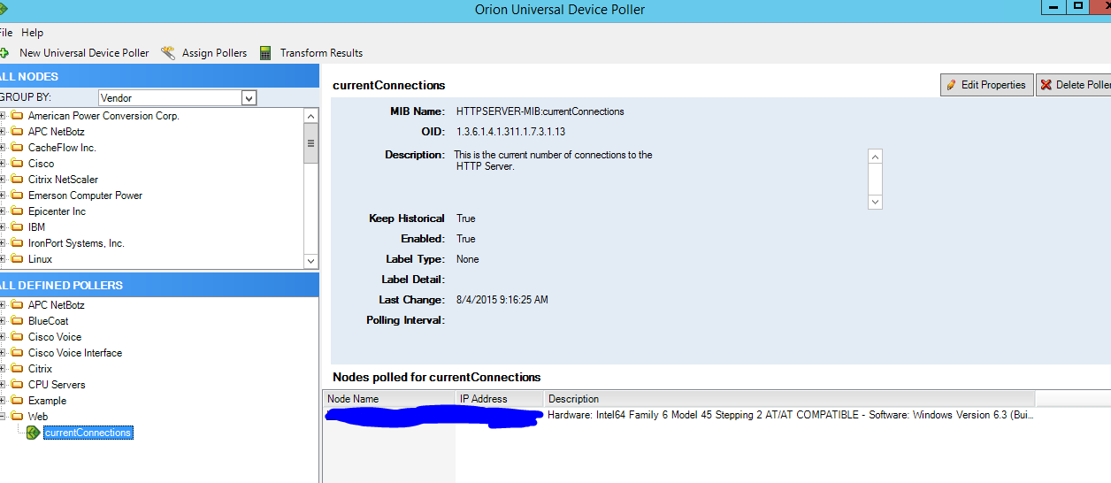

I am attempting to use the oid 1.3.6.1.4.1.311.1.7.3.1.13 but when creating the custom poller and adding my SW server, when testing the connection it times out.
Any ideas why?

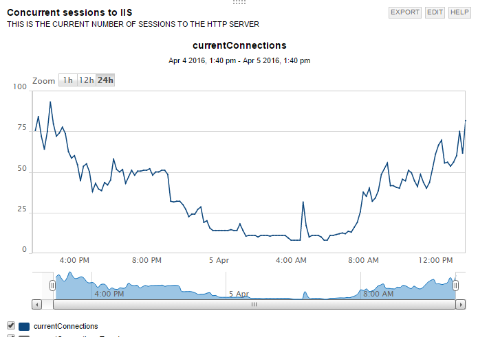

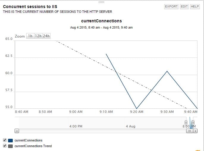

So I was asked in a PM how did I set this up. I did this though orion UDP (pictured below,) then added a universal device poller chart to my orion's node summary page (botom pic.) I hope this helps.
