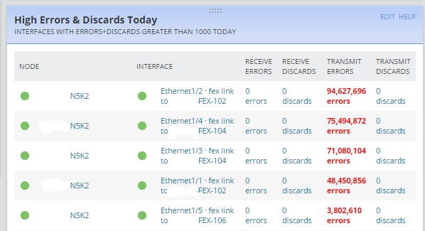

I notice that my NPM shows high transmit error on my nexus 5000.
However when i log in to the switch, I don't see any error in that port.

I tried to search in the the community and found that someone having the same issue
Nexus interface transmit discards
Would like to check is it true that the transmit error shown in NPM is cause by the Cisco MIB ?
Any solution for this would be appreciated.
