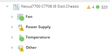

In our Nexus 7700 chassis we have always the Hardware state in warning state, because insertet, but not active SFPs are recognized as powersupply with a faulty Voltage.
So we always get a warning E-Mail about the Interface. Even if it is unmonitored or muted we get an alarm as the powersupply is recognized as part of the chassis..
I played around with the MIBs, changing them from "entitity-MIB" to "envmon-MIB" (i did this already successfully on old Chassis) but it's not working with the Nexus Chassis.
I am bewildered, these chassis are around quite a long time. There is no difference in the NX-OS versions.. 6/7/8 all showing same result
Any Ideas how i can get this correctly to work?
