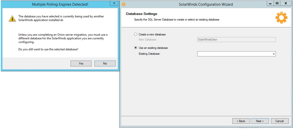

My problem:
- App Server 1 === Connected to ===> DB Server 2 ???
When I use the configuration wizard in App Server 2 and attempt to connect it to DB Server 2, I get an error message telling me that it detects multiple polling engines. From what I understand, this error is telling me that I am unable to connect the new App Server to the new DB Server because the old (active) App Server is already connected to the new DB Server somehow. While this is technically the "same" database since it was replicated from the old (active) database, it is on a completely different machine. I am confused why this is happening. To me, logically there shouldn't be any connections getting snagged since this new database I am attempting to connect to is on a new and different database server. Any help or ideas are appreciated. Thank you.
