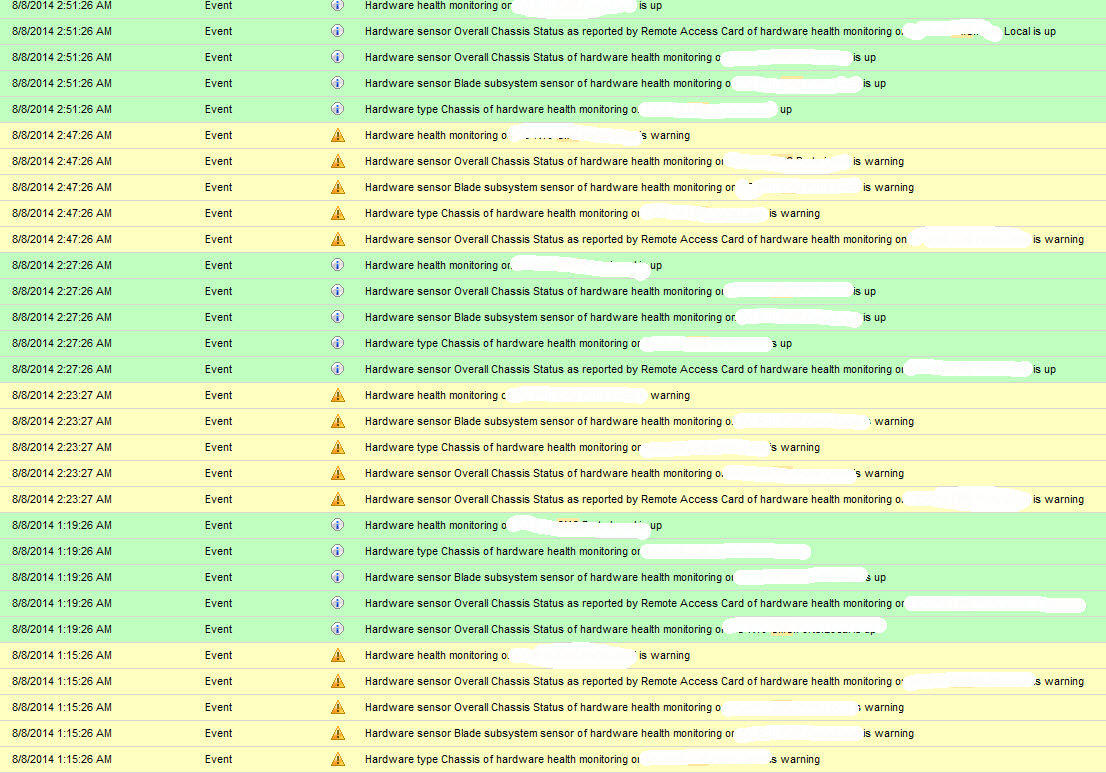

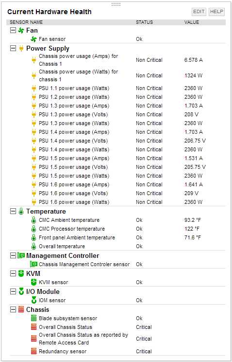

I keep getting sporadic warnings/false alerts on 2 Dell PowerEdge M1000e Blade Server Chassis. The admin says there aren't any errors on the device. What OIDs are being used for these chassis sensors below AND what table(s) are the results stored in?
- Blade subsystem sensor
- Overall Chassis Status
- Overall Chassis Status as reported by Remote Access Card
- Redundancy sensor
The hardware health results for the Blade subsystem is currently showing this (at the 1 minute reporting interval). (It's unusual that there haven't been any warnings, but normally there are some for different times than what I'm getting from the UnDPs.)

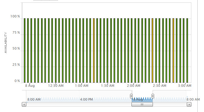

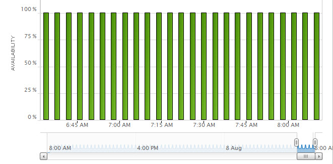

- Adjusted node polling to from 3 to 2 min. (The Alert triggers when condition > 4 min).
- Adjusted the statistics collection to every 4 minutes (instead of 10) so it doesn't look like the warning was lasting 10 minutes. [It seemed to "average" the 5 statuses together, such as OK, OK, Warning, OK, OK, with a result of Warning; which was making it hard for me to troubleshoot what was really going on.]
