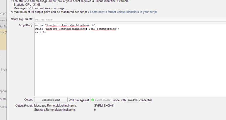

On page 39-40 of that guide it shows using a simple test script to test functionality and I am able to get the expected Output Result.

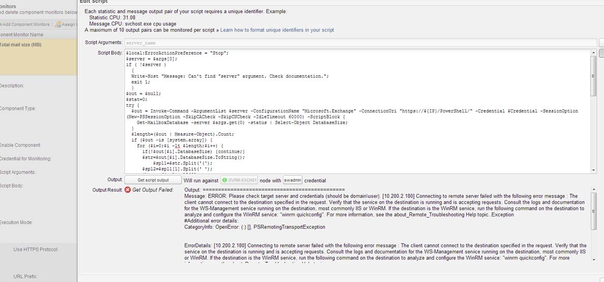

Where I am running into trouble is when I try and run the actual script that is included with the Component Monitor. Execution Mode is set to Remote Host, and Use HTTPS Protocol is set to true. Please see the screenshot below:
Template: Exchange 2010 Statistics with Powershell
Component Monitor: Total mail size (MB)
Here is the full error output:
Output: ==============================================
Message: ERROR: Please check target server and credentials (should be domain\user). [10.200.2.180] Connecting to remote server failed with the following error message : The client cannot connect to the destination specified in the request. Verify that the service on the destination is running and is accepting requests. Consult the logs and documentation for the WS-Management service running on the destination, most commonly IIS or WinRM. If the destination is the WinRM service, run the following command on the destination to analyze and configure the WinRM service: "winrm quickconfig". For more information, see the about_Remote_Troubleshooting Help topic..Exception
#Additional error details:
CategoryInfo: OpenError: (:) [], PSRemotingTransportException
ErrorDetails: [10.200.2.180] Connecting to remote server failed with the following error message : The client cannot connect to the destination specified in the request. Verify that the service on the destination is running and is accepting requests. Consult the logs and documentation for the WS-Management service running on the destination, most commonly IIS or WinRM. If the destination is the WinRM service, run the following command on the destination to analyze and configure the WinRM service: "winrm quickconfig". For more information, see the about_Remote_Troubleshooting Help topic.
FullyQualifiedErrorId: PSSessionStateBroken
InvocationInfo: System.Management.Automation.InvocationInfo
#End error details
The output result seems to indicate it's an issue with credentials, or the connection details on the target server. I was under the impression that based on the result of running the test script shown in that guide (pg. 39-40), that those details were correct. I know the credentials are correct as I am able to run stuff like Get-MailboxStatistics from the Exchange Management Shell on the SAM server. As for the server details, it appears to be using the right server as the IP address as referenced (10.200.2.180), in the Output message above. It is also mentioning issues with the WinRm service, but I'm also skeptical on that error.
