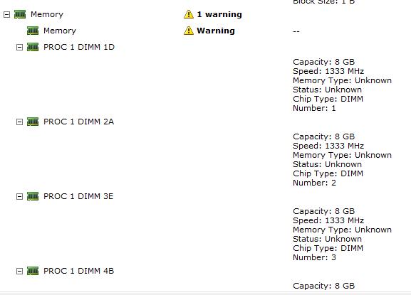

Having a problem with Hardware Monitor and some, not all, blades in a HP c7000 chassis. We had a blade that had some bad memory, and Orion reported memory in yellow as "degraded", as I understand it there were also errors and events both in VMware and the HP manager(i am no server guy.. thank god). The server team replaced the affected memory and the errors all cleared up on their side, however hardware monitor in Orion is unchanged and still shows a yellow warning for memory being degraded.

SO the problem I am faced with now is as any particular HP blade has a problem it reports that problem to Orion and then that error is forever stuck. We don't seem to have the ability to clear the error or reset it after the condition has been cleared on the other side.
