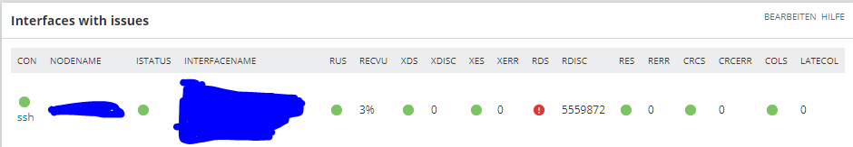

I wanted to create an alert for the last 24 hour errors.
Only thing i found is the InErrorsToday field:
But this counts errors from midnight.
I have an issue with this field since the "errors Today", and "Error last hour" drops to 0 at 12 AM.
Additionally the traffic drops to 0 at night so also the error rate drops.
Causing the alert to reset at midnight and trigger a few hours later.
We create tickets based on the triggering of this alert. But we dont want our ticketing system to be spammed each day at midnight for a thing that is a continous issue.
