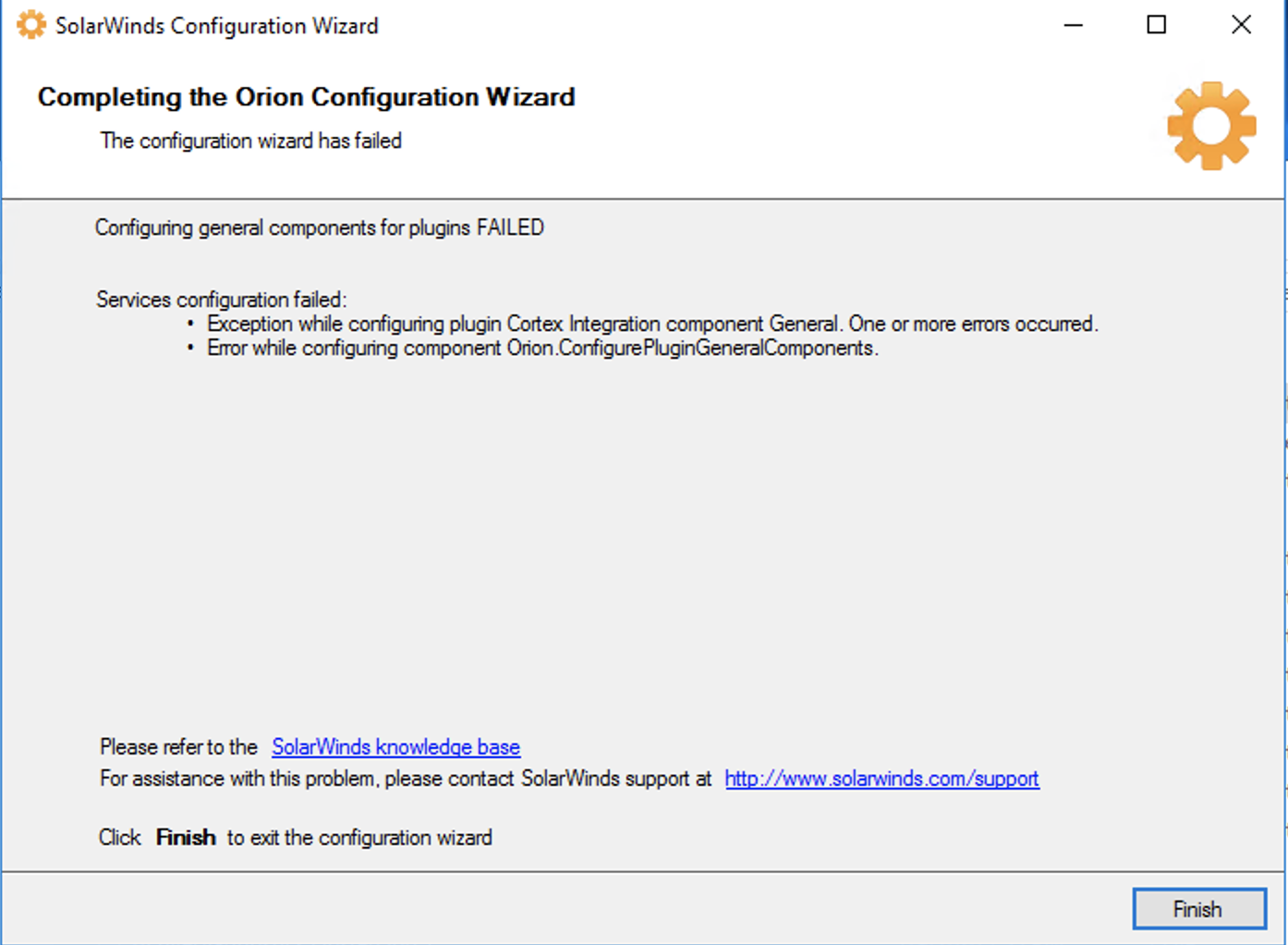

I am currently having trouble upgrading from SAM 6.7.1 (Orion Platform 2018.4 HF3) to SAM 2019.4.1

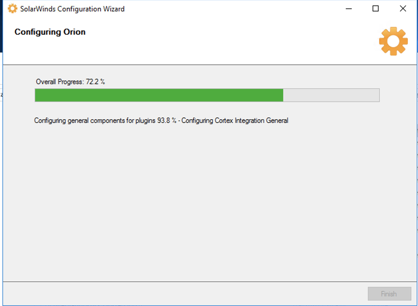

The actual software install seems to go fine, but a problem arises during the configuration wizard.
I get to this point, and the wizard hangs and runs transactions continually on the DB until the transaction log fills up at 100GB.
Overall Progress: 72.2%
Configuring general components for plugins 98.8% - Configuring Cortex Integration General
It sits here for approximately 30 minutes, then will fail.
According to a DBA that looked in to the database during the 'hang' period:
"There is a common table expression running that is filling up the log"
I can see a repeating pattern in the configuration wizard log during this time:

This continues until the database transaction log fills up.
Before the upgrade, the database mdf was 34GB allocated with 22GB data inside. The log file was 45GB allocated with 1GB of data inside.
After the wizard fails. the DB is 67GB and the log is 96GB
