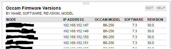

SELECT *FROM( SELECT n.NodeID, n.Caption, n.IP_Address, cs.RowID, cs.Status FROM CustomPollerStatus cs JOIN CustomPollerAssignment ca ON (cs.CustomPollerAssignmentID=ca.CustomPollerAssignmentID) JOIN CustomPollerS cp ON (ca.CustomPollerID=cp.CustomPollerID) JOIN Nodes n on (ca.NodeID=n.NodeID) WHERE cp.UniqueName='Occam_Firmware_Version' -- use your custom poller name AND n.Vendor LIKE '%occam%' /*AND n.Caption='node_name'*/ ) --here you can specify the nodeAS SourceTablePIVOT(MAX(Status)FOR RowID IN ([9.0],[13.0]) -- change the numbers if your polled RowIDs have different values) AS PivotTable
ORDER BY '9.0', '13.0', 'Caption' ASC
The query above provides us a nice list of the firmware versions for our devices.
(These devices breakdown their firmware versions into 2 parts, and then store those 2 parts in an odd location, which is why we must use custom pollers, and poll 2 separate fields.)
Our custom poller pulls the table that contains the different parts of the firmware.
RowID 9.0 is the Software part of the version.
RowID 13.0 is the Revision part.
Both of these, together, give us what we need. (It sure would be great if they would just give us the entire firmware version, and put it where everyone else does...)

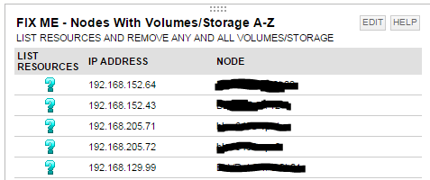

I made the following SQL query to show me a list of all the nodes that are currently polling volumes/storage.
SELECT DISTINCT t1.[NodeID],t1.[IP_Address],t1.[Caption]FROM [SWNPMDB].[dbo].[Nodes] as t1JOIN [SWNPMDB].[dbo].[Volumes] as t2ON t1.[NodeID]=t2.[NodeID]WHERE t1.Testing<>'TRUE'ORDER BY t1.[Caption] ASC
So, on the page, my team sees this list, and can easily list resources for each node by clicking the question mark.
