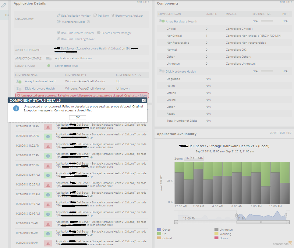

The error it throws in the application's detail page is
Unexpected error occurred. Failed to deserialize probe settings, probe skipped. Original Exception message is: Cannot access a closed file.. |
and in C:\ProgramData\SolarWinds\Logs\APM\ApplicationLogs it shows
[STP Pool:66 Thread #1] [C23522] ERROR SolarWinds.APM.Probes.ProbeBase`1 - Failed to deserialize probe settings. System.ObjectDisposedException: Cannot access a closed file. |
