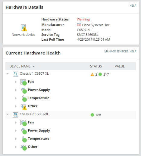

I tried with paint.net, in network atlas i see :
The symbol is blank, what is should be because the status is up
When i go looking in Orion is see :
The blank symbol is green from the up status.
I would like to see nothing if the status is up.
Am i doing something wrong ?
