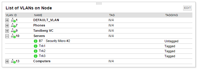

I'm starting a runbook for troubleshooting incorrect VLAN assignment, and I realized I'm missing leveraging Orion NPM's power to make troubleshooting simpler.
What ideas can you come up with to improve this non-Orion-based troubleshooting flow, that could include NPM and NCM?

Orion NCM/NPM tools to use to quickly prove a VLAN is incorrectly assigned to a port (Here's where your suggestions come in):
- Search NCM 's config change reports to find logs of the specific port's configuration change in the last X days
