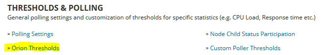

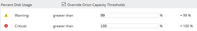

We decided to use 'Orion General Thresholds' to set our standard.
URL: /Orion/NetPerfMon/Admin/NetPerfMonSettings.aspx
This gives us the ability to set a standard that all volumes get, and allows us to 'override' the threshold on a volume by volume basis.

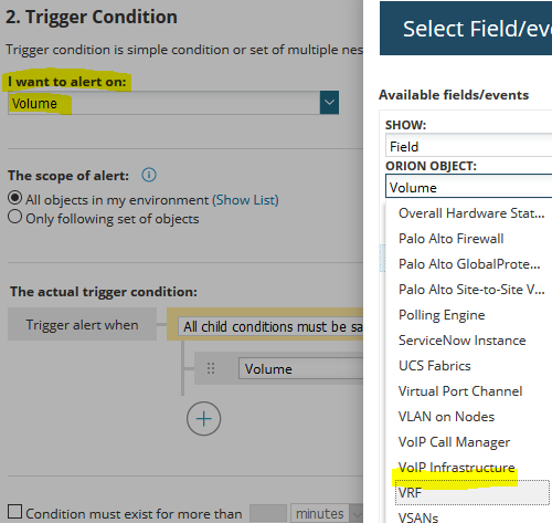

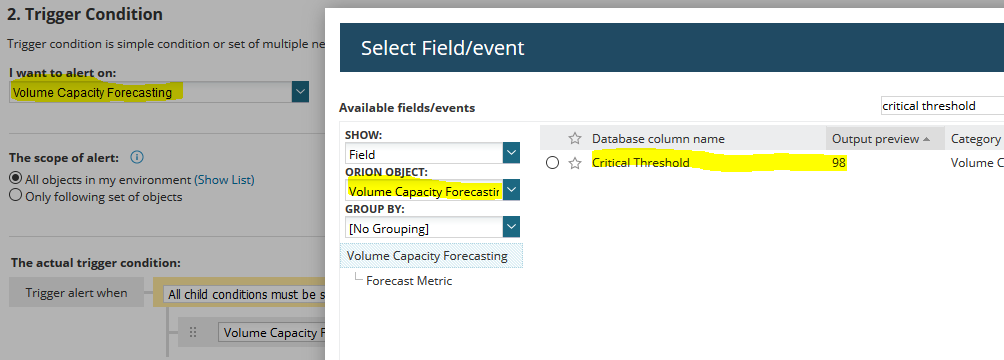

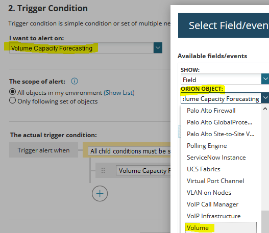

The first problem I ran into is the alert builder WebUI. When setting alert context ("I want to alert on:") to 'volume'. The 'Orion General Threshold' is not exposed. It is only exposed under ‘volume capacity forecasting’.
I can link between ‘volume capacity forecasting’ to 'volume', but not the other way. While SQWL has linkages between 'Volume' and ‘volume capacity forecasting’ the alert builder WebUI cannot see in both directions.
This was fairly easy to work around. I set the alert context to ‘volume capacity forecasting’ and linked to 'Volume' to get percent used.
Alert build WebUI with alert set to ‘volume capacity forecasting’, exposing ‘Orion General Thresholds’
‘Volume Capacity forecasting’ linkage to ‘volume’

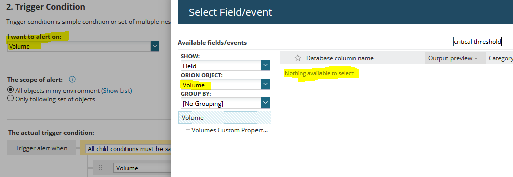

Alert build WebUI with alert set to ‘volume’ not exposing ‘Orion General Thresholds’
‘Volume’ has no linkage to ‘volume capacity forecasting’

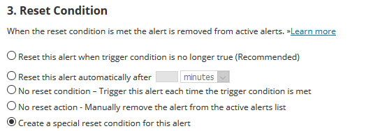

After a lengthy support case we set a custom reset condition on the alerts. Original using default "Reset this alert when trigger condition is no longer true (Recommended)".
The new reset condition is a copy of the trigger condition and reversing the operator.
Trigger
Reset
