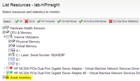

Asset Inventory is a function of Server & Application Monitor, and is not included with NPM. Have you tried clicking "List Resources" on a server, such as Windows, Linux, AIX? Do you see an option to select Asset Inventory?
Yes, on the nodes I have tested this with that option is available when "Listing Resources" however when I do an import on those nodes they do not get Asset Inventory added.
I would suggest doing a test. Take an existing node that does NOT have asset inventory enabled, but verify Asset Inventory is supported on the device by looking at List Resource for that node and ensuring Asset Inventory is listed as an available option. Next, create a new manual discovery in Network Sonar for just this one node and run the discovery manually, importing the results. Next run "List Resources" on the same node and see if Asset Inventory is selected. If it is not, please open a case with support so we can determine what the issue is, since this should work as described above.
