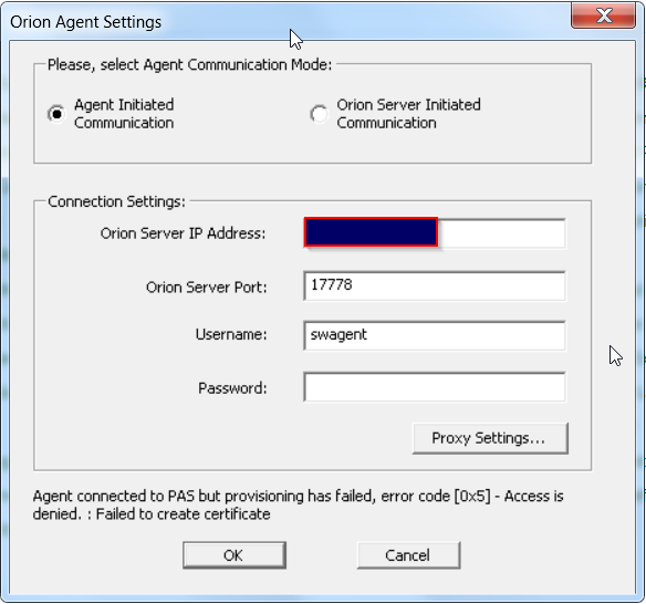

The following error occurs when the agent deployment fails:
"Agent connected to PAS but provisioning has failed, error code [0x5] - Access is denied. : Failed to create certificate"
The only way to see this error is to remotely connect to the host, launch the Control Panel then view the Orion Agent Settings, and manually enter the connection settings.

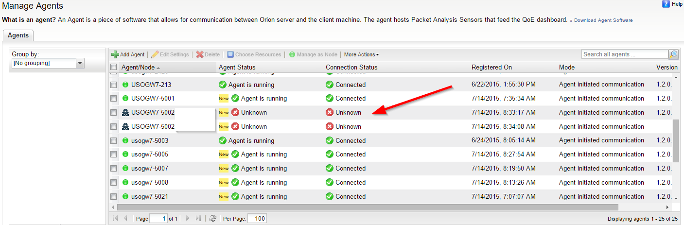

In addition to the agent installation failing, the same agent/node consistently keeps on trying to register and displays duplicate entries every few minutes in Manage Agents as shown in the example below:
How many duplicate entries occur you might ask? About 100 per day. The only way to stop the duplicate entries from showing up in the Manage Agents screen is to remotely connect to the target PC then manually remove the agent software from Programs and Features.
