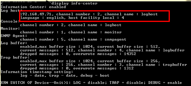

I am able to make the 3Com switch send out logs to the syslog viewer using the below command.
info-center enable
info-center loghost <ip address syslog viewer> channel o

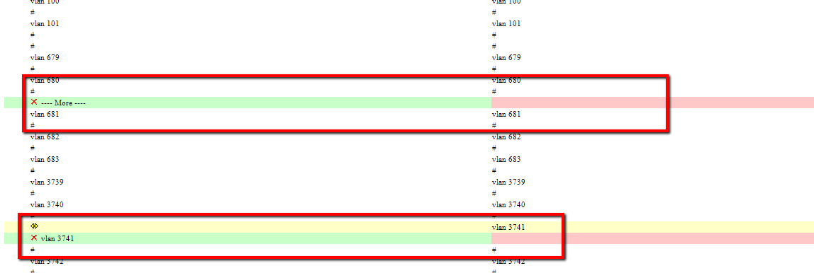

I have changed the RealTime alert message on the syslog viewer alert to look for "Configure changed"; I also tried "command:system-view" but they send over way to much information rather than just what was changed. Also, it is not consistent. I don't always get an email when something is changed. Also, it is reporting on line changes that are false-positive. Here is a sample of the Real Time Config Notice email (see below)
