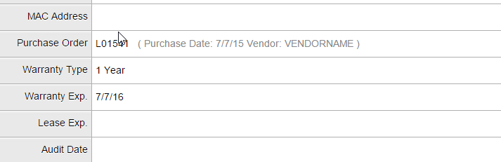

Hmm.. not sure what might be going on here. When i am looking at an asset (asset #9 in this case) and go to the Ticket Details tab, i get this view:
When you say "if i click to see purchase date and warranty expiration", what exactly are you clicking? A screenshot or two may be helpful to understand the issue.

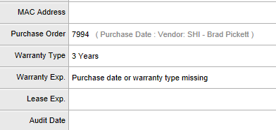

This is what my screen looks like. I don't see the Purchase Date like your screen shot so mines not filling in the Warranty Exp. field.
OK so if you look at the asset and that is set to use the purchase order...i believe it is wanting to accept the "Order Date" from that PO as the purchase date for the asset record. So, if you open PO 7994, do you have an Order Date set in there?
Incidentally, i do now understand what you mean about the field being cleared if you are in an asset record and switch between "set purchase date manually" and "po number". that seems odd for sure and might warrant a ticket to tech support.
After looking at your snapshot of your screen one of our admin guys got it to work for me now. We just needed to add more information to our table. BTW I did open a ticket with tech support with the solution “that’s the way it’s
Intended to work”. Thanks for answering my post you actually did help with just a screen shot .
