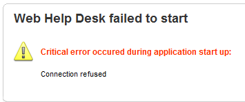

I am facing an issue where the below error keeps showing when i try to start the web app. I was testing many things but i notice the error after i was tiring to replace the logo.png in the directory "<WebHelpDesk>/bin/webapps/helpdesk/resources/images". I did try to recover the orginal logo.png but still the same error show up.
I did try to take backup of the databse so i can do a fresh installation but with no luck. if i try remotely with "pgAdmin III" i get the below error:
C:/Program Files/PostgreSQL/9.4/bin\pg_dump.exe --host WHD --port 20293 --username "whd" --no-password --format custom --blobs --verbose --file "C:\Users\####\Desktop\WHD_Backup.backup" "whd" pg_dump: [archiver (db)] connection to database "whd" failed: could not connect to server: Connection refused (0x0000274D/10061) Is the server running on host "WHD" (#.#.#.#) and accepting TCP/IP connections on port 20293? Process returned exit code 1. |
I also tried to do it localy on the server using "pg_basebackup" loockated in directory "<WebHelpDesk>/pgsql9/bin" with postgres user but i am getting the below error:
bash-4.1$ ./pg_basebackup -D Test/ -p 20293 pg_basebackup: could not connect to server: FATAL: no pg_hba.conf entry for replication connection from host "[local]", user "postgres", SSL off |
I am using the VM Centous OS version.
