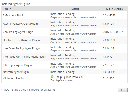

So I understood that there was a problem with agent plugin and when I checked the agents, Though the agent status was OK the plugin status was either Pending or Approved state..
Agent Plugin Status
Few were in pending status few were in approved status

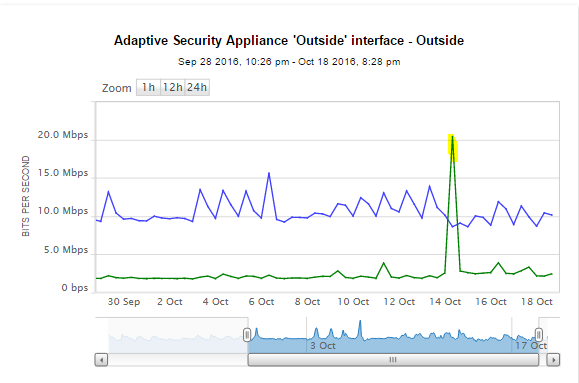

Around 50 agents the plugin was installed properly and rest were stuck.. Then I started noticing there was a latency issue. When I checked the interface utilization I was shocked to see it has grown up more than 100 % from the time, The Agent started updating
I had a hope these agent plugins will be installed without any issues, So I was just waiting for an hour and slowly each agents started Updating the plugins properly. For all the agents to complete the agent & Plugin update it nearly took 5 hours in this site because these servers were in different domain, Different network all together.

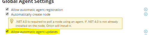

- Turn off the Allow automatic agent updates temporarily before starting the upgrade.

Once the plugin was installed properly, My network came back to normal state and SAM started rocking !!
