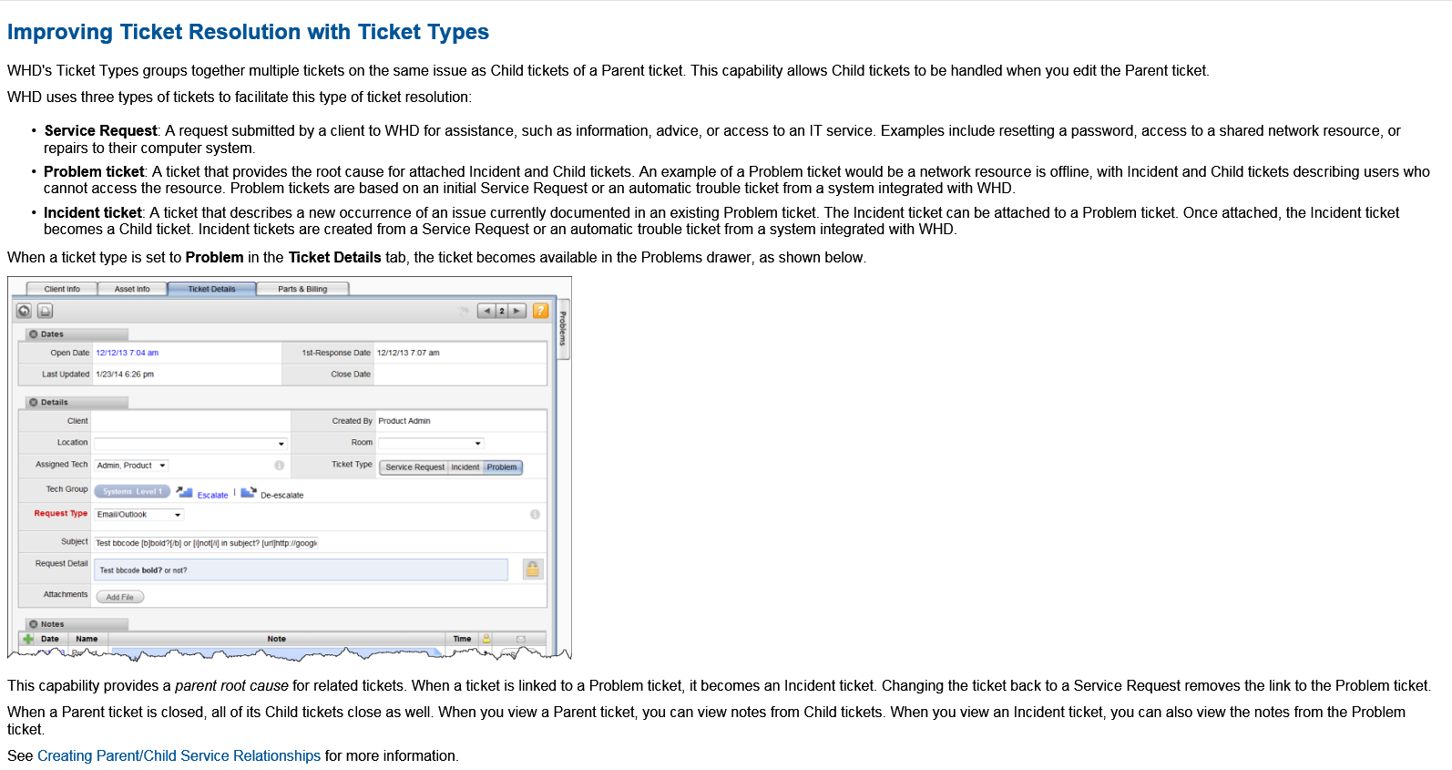

Umm, what? That's been built in to WHD since 2012.
It's even in the documentation here:
SolarWinds Web Help Desk Help
And here:
It does for Problem/ linked incident tickets but apparently not for the new Linked requests brought in in 12.3.
