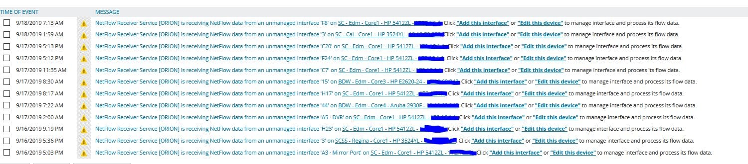

For the last week, I have been troubleshooting the unmonitored netflow interfaces in my events on the solar wind side. I still have interfaces showing up here that are 100% not sending traffic, according to my switch, they were however monitored in the past.
My only thought would be to delete the node from solar winds fully and re build that side of things.
I also have no clue why solar winds would see this data, unless the switch was actually sending it. Its not regular like sflow is normally, and its not at a specific time.
Here is a screen shot.
