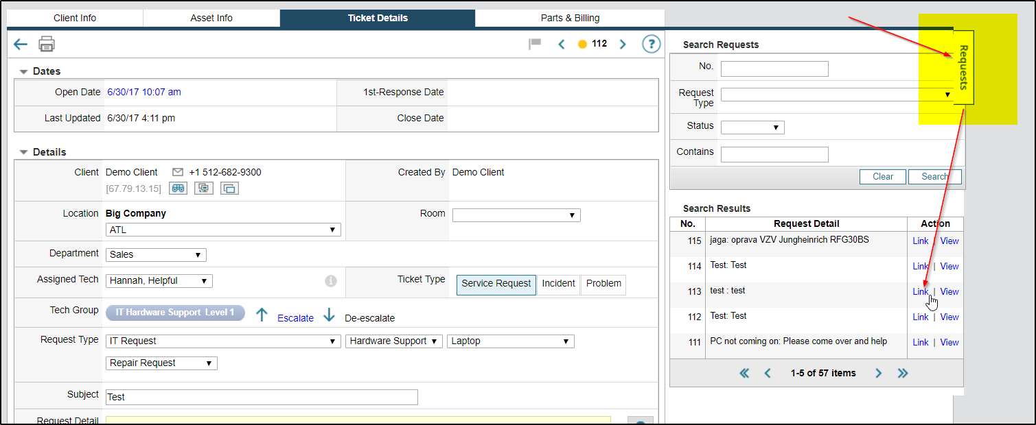

You go into a a ticket. The ticket you go into will be the CHILD ticket when we're done.
side note: I believe it needs to have a Ticket Type of "Service Request" - not an "Incident" or "Problem"
Once in the ticket, look up on the upper right.
There is a little sideways "Requests" option up there...click that, then hit "search" and it will show you a list of other tickets.
Click the "Link" button for the ticket that you want to be the Parent.
Save the ticket.
Now, from within either ticket you can see the relationship - there will be a little section for "Linked Parent Ticket" or "Linked Child Tickets" depending on which one you are in.

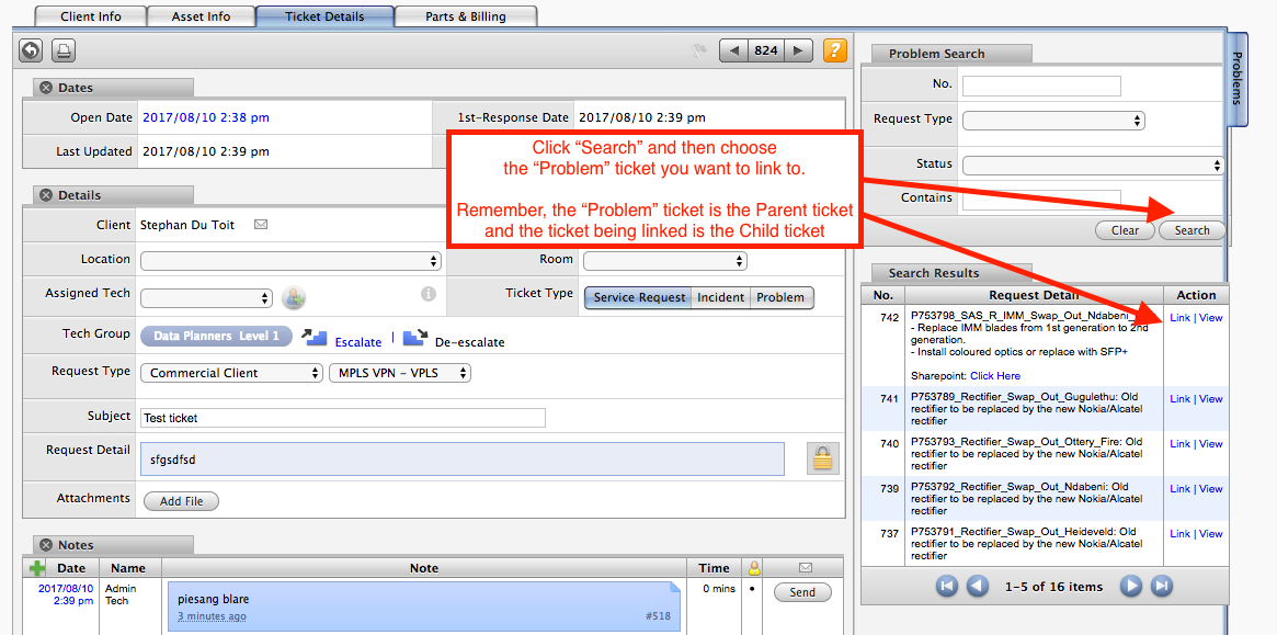

Hi Sbaskerville,
Yes I did.

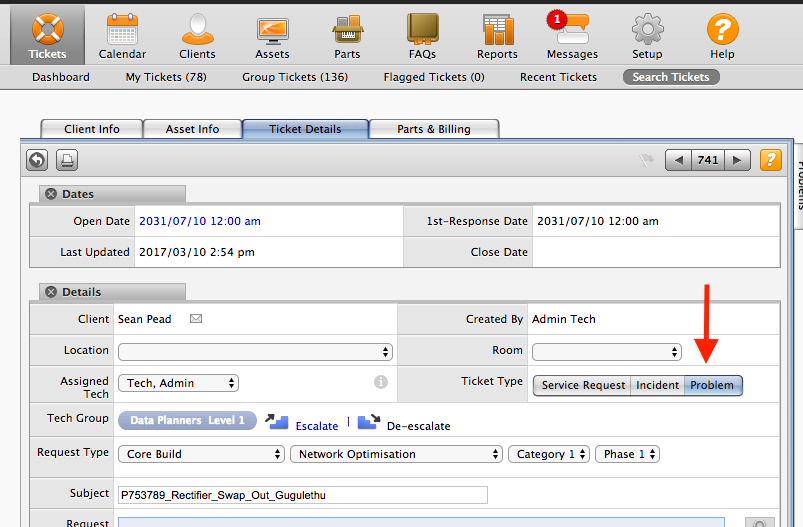

You need to mark your main or Parent ticket as a "Problem":

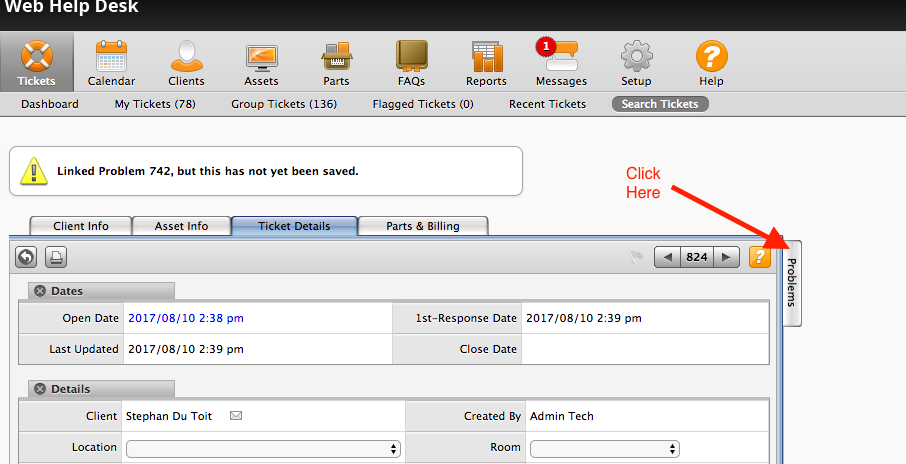

Then open the ticket (Child) you want to link to the Parent ticket and click on "Problems" tab:
Next, click "Search" and choose the "Problem" (Parent) ticket:
And your done.
Any updates you make to either ticket will reflect on the other.
