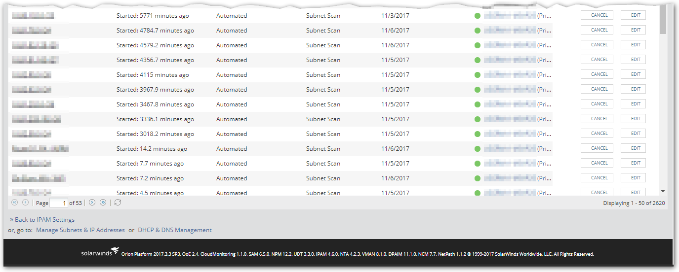

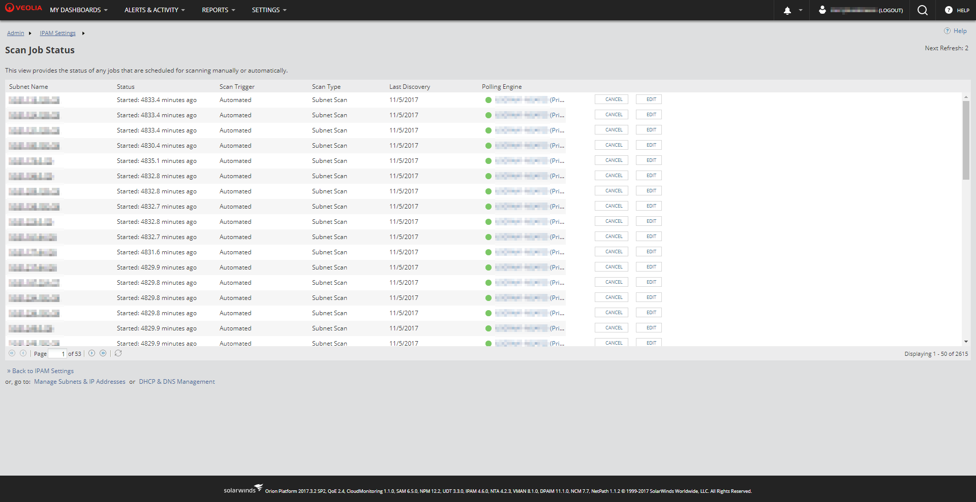

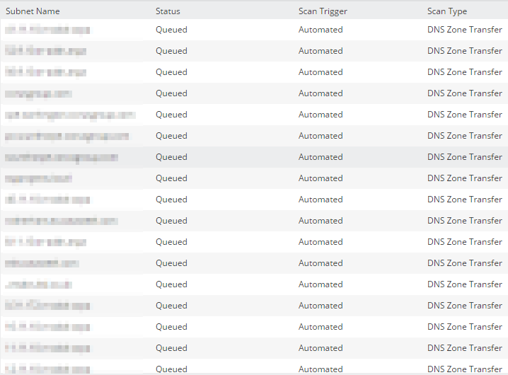

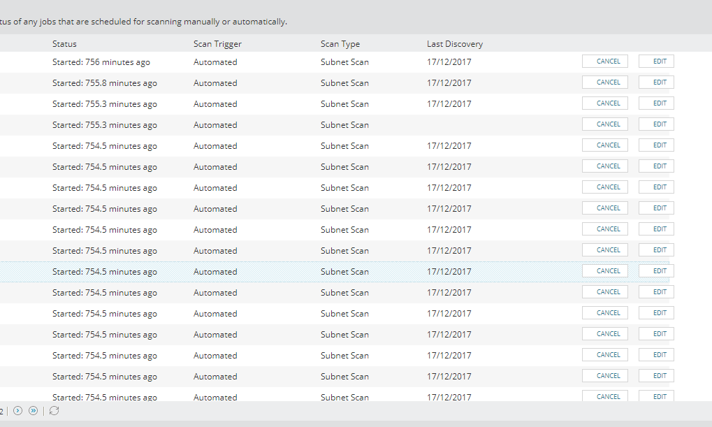

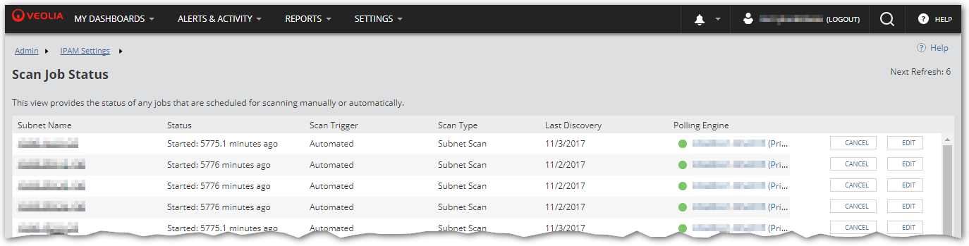

I updated my instance of IPAM to 4.6 RC1 on Sunday, November 12th. I upgraded to 4.6 RC2 on Thursday, November 16th. Over the next couple days, I noticed a number of issues in 4.6 and contacted support on Friday, November 17th to report these issues.

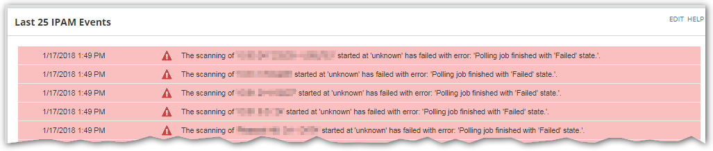

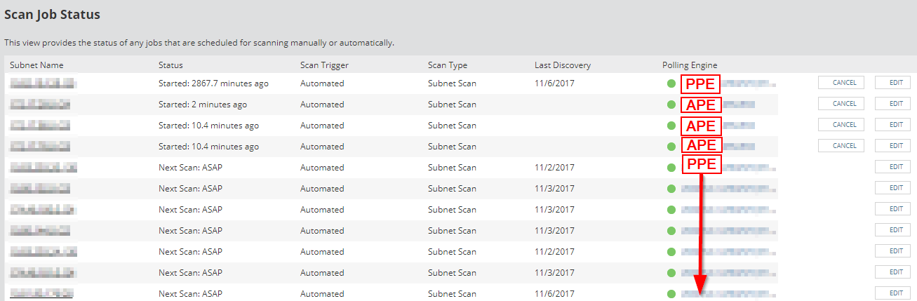

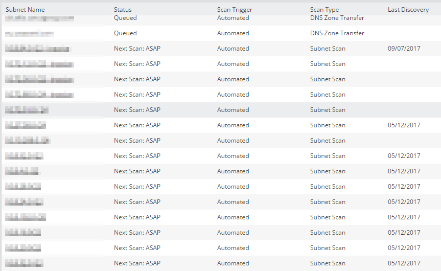

The first issue I encountered was that my IPAM polling jobs are queuing up but, not finishing regardless whether they're running from the primary or additional polling engine. These jobs don't seem to be completing regardless if they were automated or manually started. The "Last Discovery" field isn't incrementing and the "Status" field for most subnets has a started time of 5000+ minutes ago.

I did notice that the "Polling Engine" field under the "Automatic Scanning" option in "Edit Subnet Properties" was blank for all our subnets.

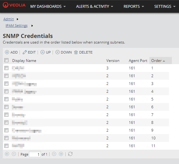

Hello Josh, Go to IPAM Settings >> SNMP Credentials. Take a screenshot.
Sincerely, Alejandro Jay Realo |

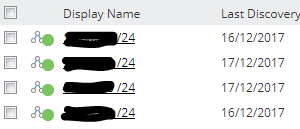

I did so and following up with another finding the same day:
I have updated my environment with IPAM 4.6.0HF3 and the issue remains. If I run a manual scan on any of the "stuck" subnets, they complete successfully (however the "Last Discovery" date doesn't change).
The fact that the manual scan works and that the auto scan jobs worked prior to installing 4.6RC I would think that there isn't any issues with my DHCP/DNS credentials. Please advise what else can be done or if you'd like to schedule another webmeeting to look into this. Thanks, |

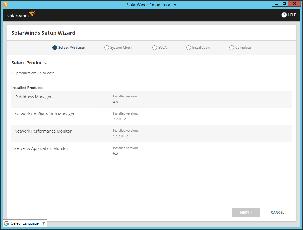

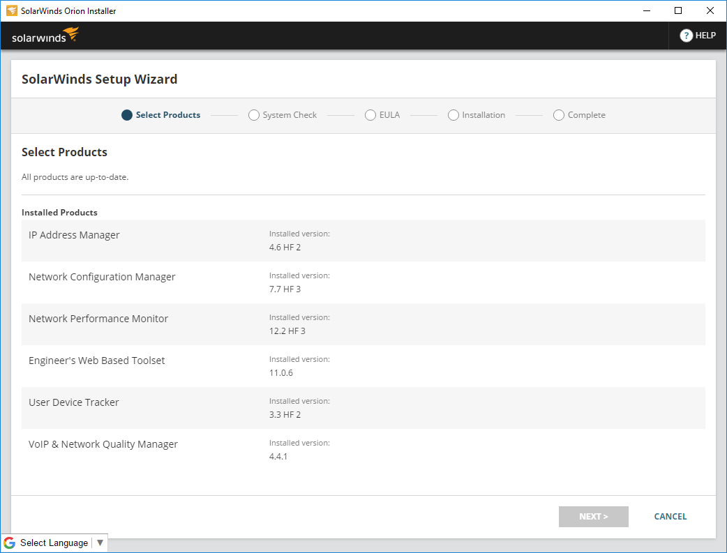

On Wednesday, December 6th I updated to IPAM 4.6 GA and the issues persisted.

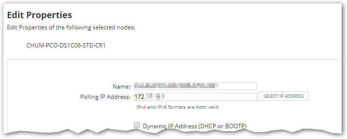

Node # 4954 is being monitored in NPM by the additional polling engine *removed* It is a Cisco Catalyst 4500 that is also setup in NCM with credentials that have full "enable" access.

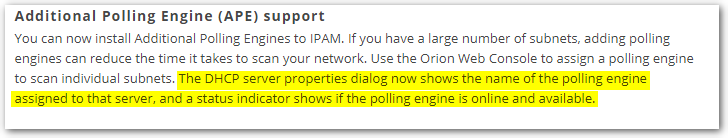

When I attempt to test it using the same credentials that NCM uses in IPAM, I receive an error that states "Test Failed. Node 4954 is not on the Main poller. Please move node to the Main poller and try again."
Per the IPAM 4.6 release notes here: https://support.solarwinds.com/Success_Center/IP_Address_Manager_(IPAM)/release_notes "The DHCP server properties dialog now shows the name of the polling engine assigned to that server, and a status indicator shows if the polling engine is online and available."
I have also uploaded the diagnostics as requested. Please let me know when we can work to resolve this asap as adding DHCP server from the APE is a critical feature for us. Thanks, |

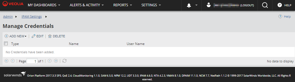

On Thursday, December 21st I noticed that the "Credentials for scope scans" under "Manage Credentials" is blank and shows "No credentials have been added." I currently have a number of credentials that are assigned to numerous scope scans and have even tried to add new credentials without them showing up. I contacted support and Case # - 00027114 - Manage credentials on IPAM settings is blank. was created for this.
On Friday, December 22nd I conducted a Webex with Dave Roallos for this issue and he had me export and upload diagnostics for this.
On Tuesday, December 26th I received the following up for Case # - 00027114 - Manage credentials on IPAM settings is blank.:
Hi Joshua, Good day. Thank you for uploading your Diagnostics for IPAM and UDT, I already consult this case and mention with our Application Engineer that you also have a case that's already with our DevTeam. Regards, Earl Chrys B. Caranguian |
