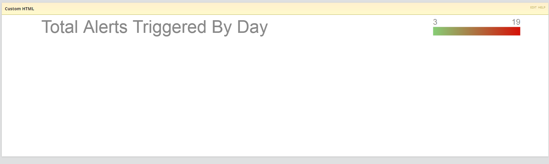

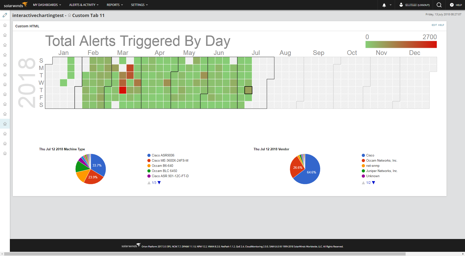

Trying something different on this post, so let's make everything easy, and just jump right into it.
If you want to display data like this:
Then keep reading...

**The various SWQL queries, within the attached file, mostly reference default table/column names. There are, however, references to NODE Custom Properties "Area" & "Department". You can either go into the file and change the column, or create the columns in your environment. (you don't have to use them, but they will need to exist)**
The queries, as they are in the attached text, simply pull ALL alerts for the current year. I know the SWQL is not as efficient as it could/should be, however, we built it this way to work for us in a manner that would be flexible enough for us while we tested. Feel free to adjust/correct to your liking.

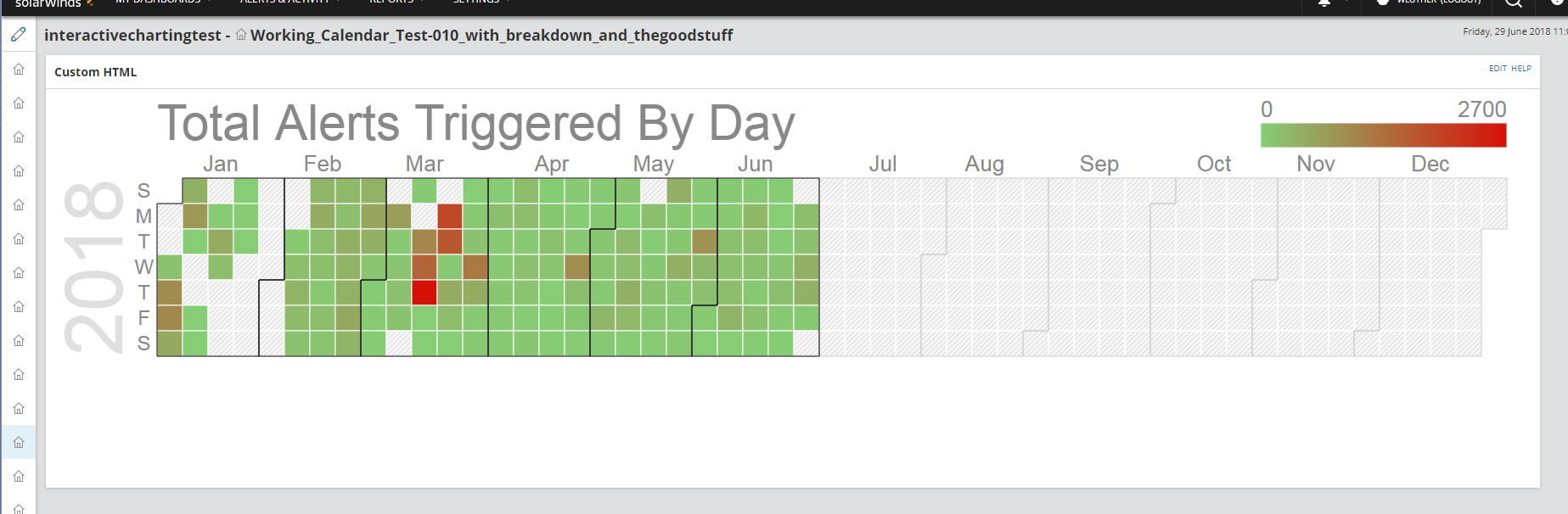

When the page loads, it starts with only the calendar displayed. (This calendar displays the days vertically, instead of the traditional horizontal layout) The calendar is showing ALL alerts triggered (up, down, left, right, node, meow, int, vader, etc.), broken down and grouped by day. The more total alerts per day, the closer (darker?) the color changes to red.

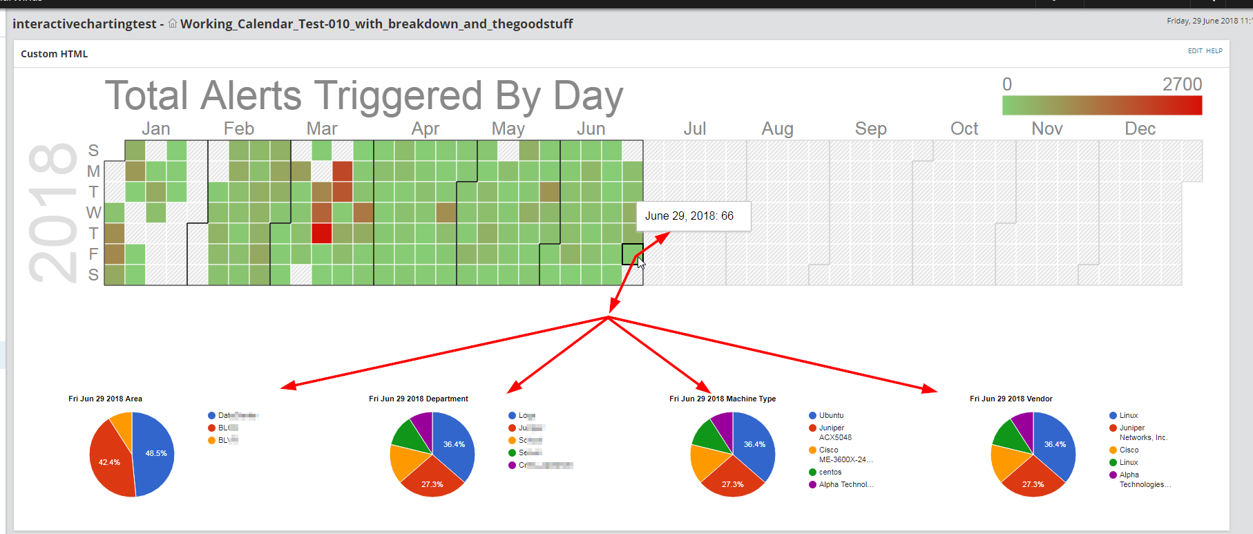

Once you click on a day, the data will be rolled down into pie charts, grouping each by a different metric. (Area, Department, MachineType, Vendor) This allows us to easily view the global trouble maker(s), showing us who/what did the most damage that day.
Clicking on different days will automatically refresh the pie charts to reflect the data from whichever day you select. (I still need to correct/adjust the grouping part of the SWQL queries for the pie charts, as they should not show multiple entries for the same results. ie. vendor should only show 1 of each vendor, but it currently shows some vendors multiple times.)
