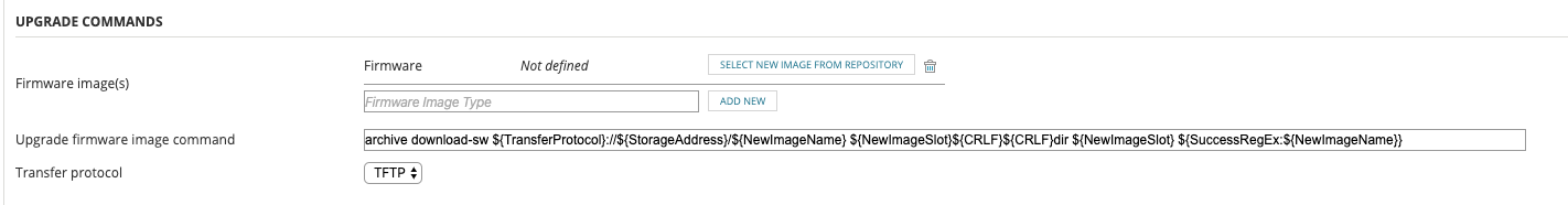

so first you need to modify the firmware repository to be able to see TAR files (if they can't already) this link should help with that Firmware repository file extensions
Then you'll need to do modify your upgrade template to issue the appropriate commands for the upgrade see the below screenshot for an example on a 3750

Were you able to get the upgrade to work? I'm think I'm trying to do the same thing and still having some problems. I'm trying to run a firmware upgrade through Solarwinds for a Cisco 2960-X switch stack. Because of the availability of the archive download-sw command, I think that the included 2960 template can be significantly simplified, but I'm still getting an error.
I removed most of the other commands and I have the following value for my upgrade firmware image command. It works in that it starts to run the upgrade, but then it just seems to die without error. It doesn't reload and never shows the additional output that I see on other people's log output.
archive download-sw /reload ${TransferProtocol}://${SCPServerUserName}:${SCPServerPassword}@${SCPStorageAddress}/${NewImageName}
Writing config to NvRAM...write memoryBuilding configuration...Backup Running config...Running config backed up successfullyBackup Startup config...Startup config backed up successfullyUploading Firmware Image c2960x-universalk9-tar.152-7.E2.tar on device flash:/...archive download-sw /reload scp://username:password@host/c2960x-universalk9-tar.152-7.E2.tar!!!!!!!!!!!!!!!!!!!!!!!!!!!!!!!!!!!!!!!!!!!!!!!!!!!!!!!!!!!!!!!!!!!!!!!!!!!!!!!!!!!!!!!!!!!!!!!!!!!!examining image...extracting info (110 bytes)extracting c2960x-universalk9-mz.152-7.E2/info (688 bytes)extracting info (110 bytes)Stacking Version Number: 1.119System Type: 0x00000000 Ios Image File Size: 0x01978200 Total Image File Size: 0x0276A200 Minimum Dram required: 0x08000000 Image Suffix: universalk9-152-7.E2 Image Directory: c2960x-universalk9-mz.152-7.E2 Image Name: c2960x-universalk9-mz.152-7.E2.bin Image Feature: IP|LAYER_2|SSH|3DES|MIN_DRAM_MEG=128 FRU Module Version: No FRU Version SpecifiedOld image for switch 1: unknownOld image for switch 2: unknownOld image for switch 3: unknownExtracting images from archive into flash...Extracting images from archive into flash on switch 2...Extracting images from archive into flash on switch 3...Warning: Unable to allocate memory to display the tar extraction of files, however upgrade process is still continuing. If you would like to see the tar extraction output, try upgrading one switch at a time.Warning: Unable to allocate memory to display the tar extraction of files, however upgrade process is still continuing. If you would like to see the tar extraction output, try upgrading one switch at a time.Upgrade Complete on node
If I login to the stack and run show archive status, the output shows that no upgrade is in progress...
IDLE: No upgrade in progressImage Size Downloaded: 0
