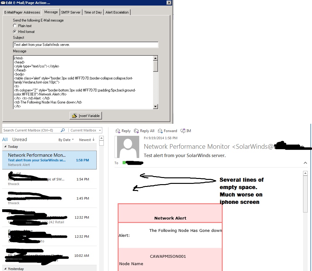

Does anyone have a suggestion how to remove the blank portion before the alert?
What I am getting in email is a small (a couple of lines) worth of just background white before i see the nice colored alert outline & then all its fields.
It is even worse on my iphone. I have to basically scroll down a page worth on the small iphone email to get to the actual html & body of the alert.
Being able to make that go away would be perfect.
Remove any extra spaces or line breaks, sometimes (1990's style) HTML can pickup those extra's and apply them inappropriately. Though I have not toyed with this one yet, I would expect there to be a loose translation of the code.
Thanks CA but as far as I can tell there is no extra line breaks.
Here is the alert code & the alert email. As I indicated the couple of lines in the pc view of the message isnt an issue but on the smaller iphone screen its like a full page down of white before i see the actual alert.
If you look at the screen cap you can see the "code" is all the way up at the top in the alert field. Yet when it comes through email there are lines of blank that seem to push the html stuff down several lines.
Yeah, run that together... and there are spaces between a Tablr Row setup </tr> <tr> <- remove that space

I did not realize the body of the html was actually where I needed to remove the space.
Taking your suggestion it appears to work now & looks like it should on the small screen of an iphone.
Thank you again!

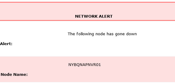

I tried using this but the formatting does not look good.

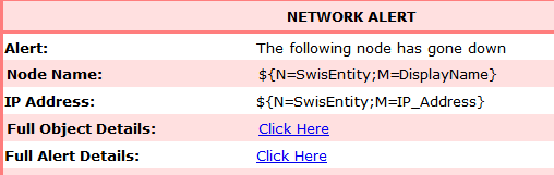

I want it to look like this when I open the html file in a browser.
But when I paste the code in Alert Manager, I get this in email.
The height of the table is too big. I even put "height" of the table in the html code.

I figured it out. Basically you have to paste the html code as one line into Alert Manager.
I saw the OP state it in another thread about it.
I can confirm this just resolved my HTML formatting issues.
DO you have a HTML Code where I can pass the Alert Variables at the end so that it can pickup the colour from the above HTML body.
You can add variables with the 'Insert Variable' button. Then cut and paste them where you need in the HTML Code. Or Build the code around your text that is already there. A lot of folks use a table so you can set the cell colors and spacing as desired
<table><tr><td>Node:</td><td>${N=SwisEntity;M=Caption}</td></tr><tr><td>IP:</td><td>${N=SwisEntity;M=IP_Address}</td></tr><tr><td>Status:</td><td>${N=SwisEntity;M=Status}</td></tr>
This is a very rudimentary example, and I would suggest adding in the variables directly from your console so they are all correct and properly aligned with the entity you are alerting on.
