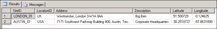

Create new table in auxiliary database called "Sites"
Note:
LocationID field will not be used in this solution, but we will need it in other solutions. So, if you have intentions of following my future SQL magic series - please create this column as well
(3)

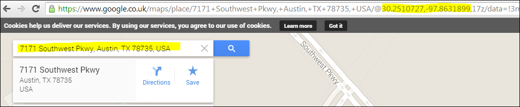

Populate this table with information about your sites, including coordinates, which you can extract from Google Map URL

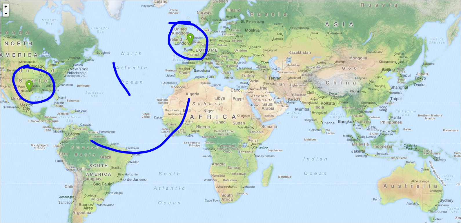

Now, here is were Magic begins... below is a SQL script which you can use to populate your World Map Points.
MERGE SolarWinds.dbo.WorldMapPoints AS targetUSING ( SELECT n.NodeID ,n.EntityType ,s.Latitude ,s.Longitude ,s.[Description] FROM SolarWinds.dbo.Nodes n LEFT JOIN SolarWindsAux.dbo.Sites s ON s.SiteID=n.n_site_id LEFT JOIN SolarWinds.dbo.WorldMapPoints wm ON n.NodeID=wm.InstanceID ) AS source (NodeID, EntityType, Latitude, Longitude, [Description]) ON (target.InstanceID = source.NodeID)-- Delete from MAP if node no longer exist in Nodes tableWHEN NOT MATCHED BY sourceTHEN DELETE-- Delete from MAP if Latitude/Longitude values were not specifiedWHEN MATCHED AND (source.Latitude IS NULL or source.Longitude IS NULL)THEN DELETE-- Update if Latitude/Longitude were changedWHEN MATCHED AND source.Latitude <> target.Latitude OR (source.Latitude IS NOT NULL AND target.Latitude IS NULL) OR source.Longitude <> target.Longitude OR (source.Longitude IS NOT NULL AND target.Longitude IS NULL) OR source.[Description] <> target.StreetAddress OR (source.[Description] IS NOT NULL AND target.StreetAddress IS NULL)THENUPDATE SET Latitude = source.Latitude, Longitude = source.Longitude, StreetAddress = source.[Description]-- Synch new nodeWHEN NOT MATCHED BY target AND source.EntityType IN ('Orion.Nodes','Orion.VIM.Hosts','Orion.VIM.VCenters') --Ideally, everything from NODES should be included, but I don't know if all objects from Nodes can be displayed on the map. --So far, I know that this values will definitely work (they will be replaced with 'Orion.Nodes' values in World Map table) AND source.Latitude IS NOT NULL AND source.Longitude IS NOT NULLTHENINSERT (Instance, InstanceID, Latitude, Longitude, StreetAddress)VALUES ('Orion.Nodes', source.NodeID, source.Latitude, source.Longitude, source.[Description]);Remember to change database name
(5)
The last thing which is left - schedule the above script to fire automatically, on schedule. Script is very resource-friendly - you can run it as often as you wish. How often - this will depend on your environment. Main questions to answer would be - how often location changes are being made by your team across all nodes and how quickly you want them to be populated on the map. In my case I decided to stick with "every 1 hour"
Please refer to the below step-by-step guide from MSDN on how to create SQL scheduled job:
Schedule a Job
(6)
... in 1 hour ...
