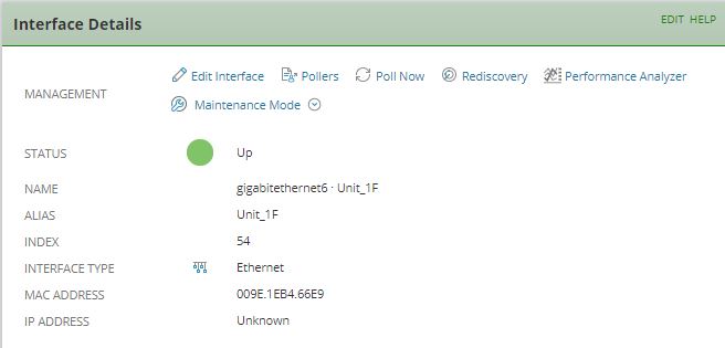

Here's how the interface in the first example looks in NPM. The Index value is shown, and matches what is given in the trap. If I could find a way to return the value in the name field, that would be ideal.
