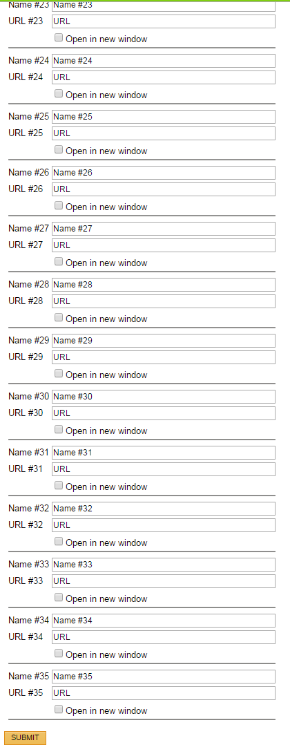

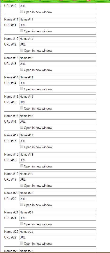

These resources simply provide more than the 10 user links allowed by the default "User Links" resource.
There is nothing special with any of these, and they should all work exactly the same as the default resource, only they will allow 15, 20, 25, 30, & 35 user links, instead of the default 10.

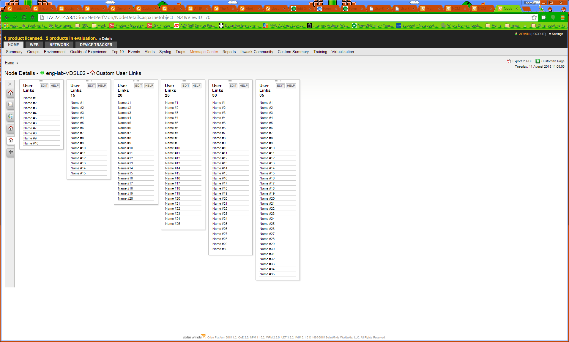

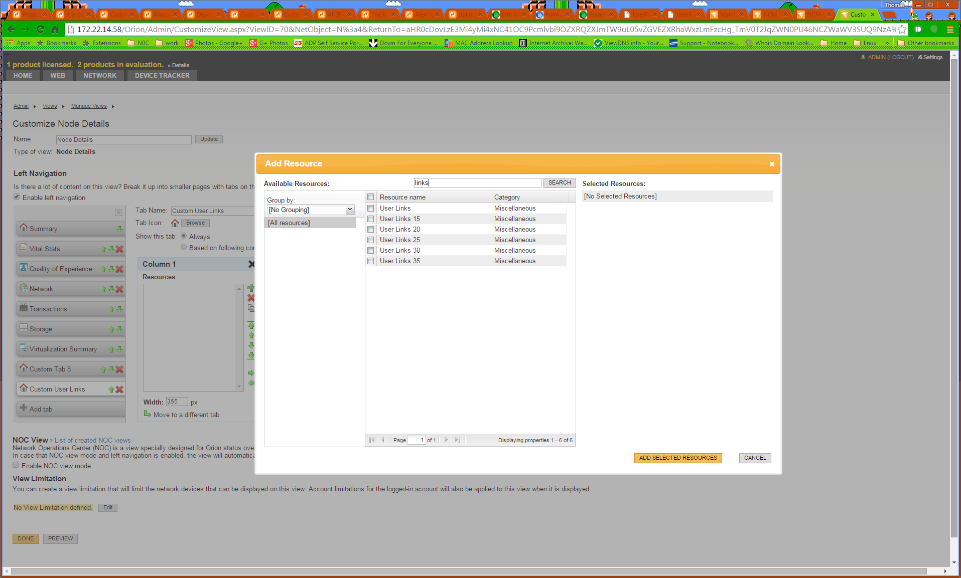

After copying the files to the correct folders, you will need to rerun the configuration wizard, and select the "Website" option. (you should leave the "Database" and "Services" options unchecked)
Once the configuration wizard has completed, you should be able to add the new resources to any page you want/need them on.
