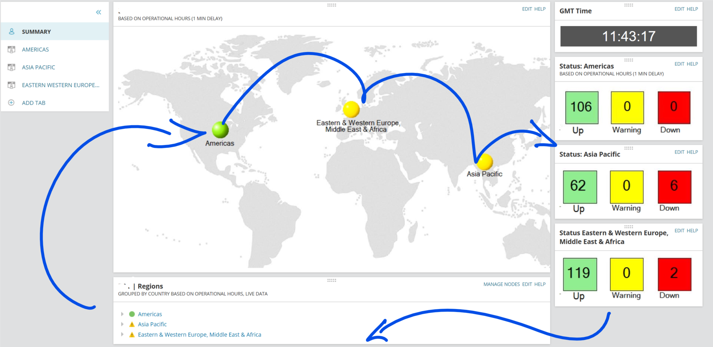

just wanted to share a requirement i recently had from a customer. The requirement was quite cool, they wanted a view that at a glance they would know the number of nodes were either up or down/warning, a map that would dynamically change based on site hours for different regions/ counties and for alerts to be surpassed during offline times.
as an example. if you have an office in London that comes online at 9am to 18pm, then you have Mexico that comes online at 9pm till 2 am, you don't necessary want alerts for Mexico at 2pm because the site is offline, vice-versa, Also you don't want maps to show sites that are down that don't really need to be there,
The view consists of 3 objects, Network atlas map, Ajax group dropdown and the scoreboard (also from Network Atlas) (requires some knowledge of SQL)

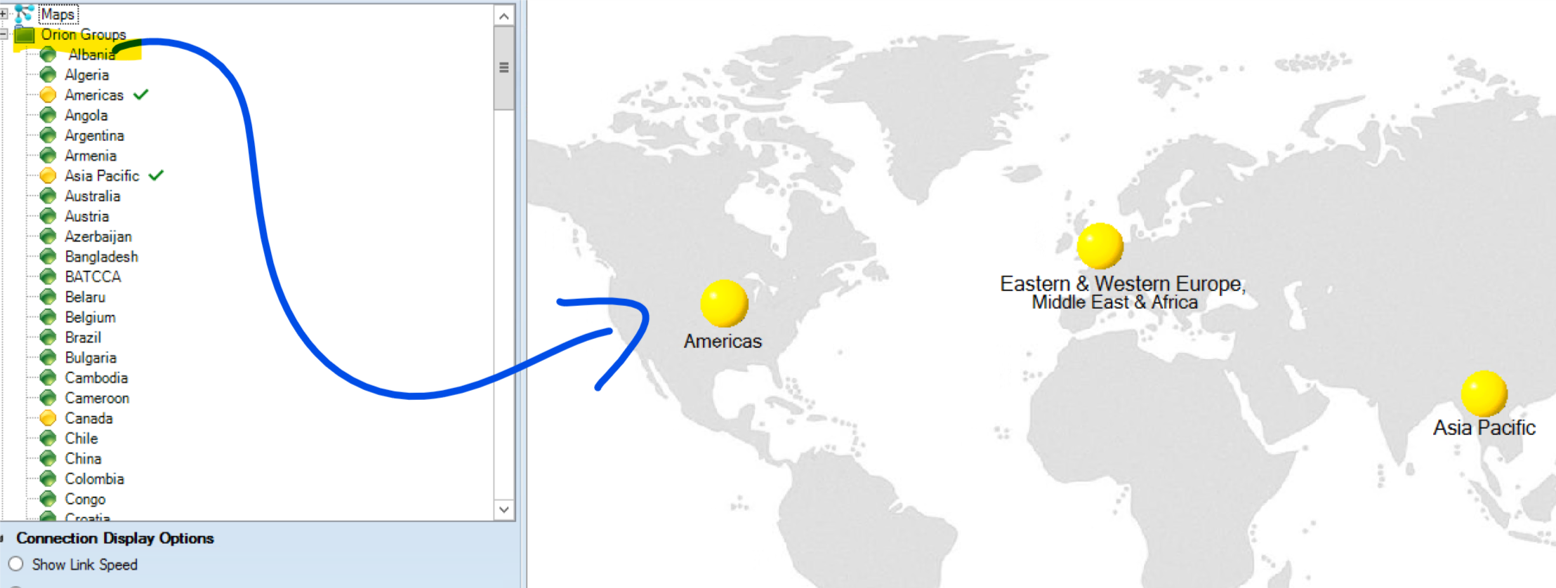

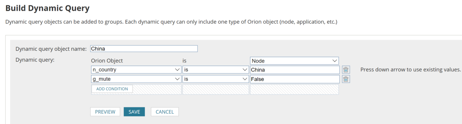

setting up dynamic group for map:
dynamic group is checking for n_region and g_mute is set to false, the reason the g_mute is set to false is because this value will update to true when operation hours are active.
for example:
n_region n_country
Now all you need to do is replicate this for other regions and also for countries (probably the hardest part but worth it:)) . once completed the grouping your be able to populate the network atles with your recently created groups simply drag and drop them.
counties in region Asia
ok that's pretty much it for now in network atlse until a little later

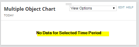

originally, i was looking for a pie chart for number of nodes that are down/up, but it seems that you can only have pie charts for NCM, NTA and think for hardware as well anyway, i went on a little Thwack hunt, and found this Scoreboard by cscoengineer thanks again bud

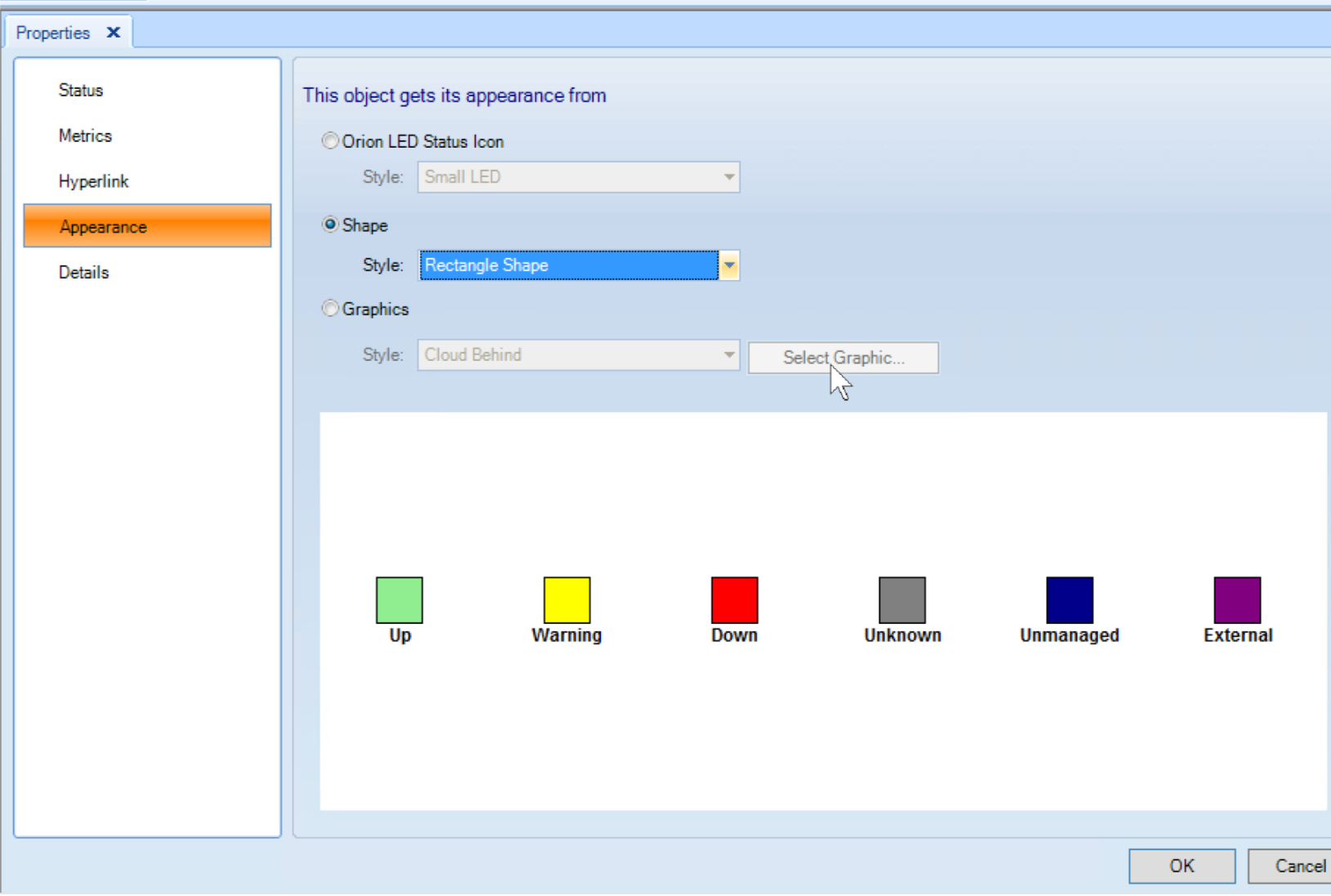

For this your need 3 custom properties and then head back to Network Atlas to build out the status boxes that will hold the data from the custom properties.
all the custom properties will do is just update from a COUNT (*) from a SQL job.
| Name | Format | Description |
| count1_up | Integer | number of devices that are up |
| count2_down | Integer | number of devices that are down |
| count3_warn | integer | number of devices that are warning |

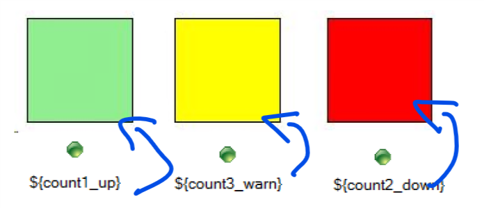

now simply create your status icons. something like this:
your need to now pick a node that will hold the COUNT data, for example below i use our primary polling engine NodeID which is nodeid 267 in the example below. this is the node that needs to dragged onto the map, your need to drag the same object 3 times, each with a different name ${count1_up} , ${count3_warn} and ${count2_down} .
secondly, your need to create another 'SQL agent job' and all within the same script input the below. just ensure you select your NodID that you used just above. (remove the 267 nodeid) i have mine running every 1 minutes because i want to capture the 'warning' status, with the check n_mute and g_mute it wont pickup the devices outside of the operation hours.

to finish off add a All Nodes - Tree (AJAX) resource and add the filter if you dont want to see the nodes outside of them operation hours.
filter: ((g_mute = '0') OR (g_mute = '0'))
group by n_region
think that does it now all maps, operation hours , status are in sync with each other
