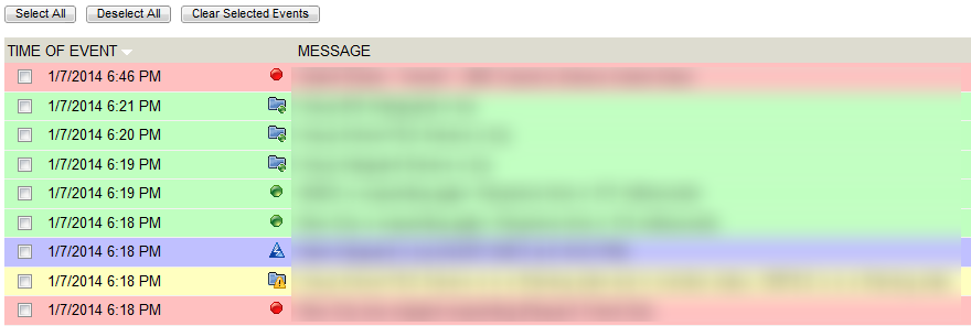

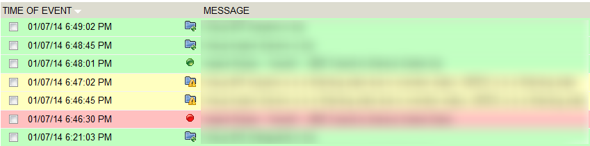

The Events Summary page only gives you the time of an event in the MM/dd/yy h:mm format, so I've adjusted it to MM/dd/yy h:mm:ss tt

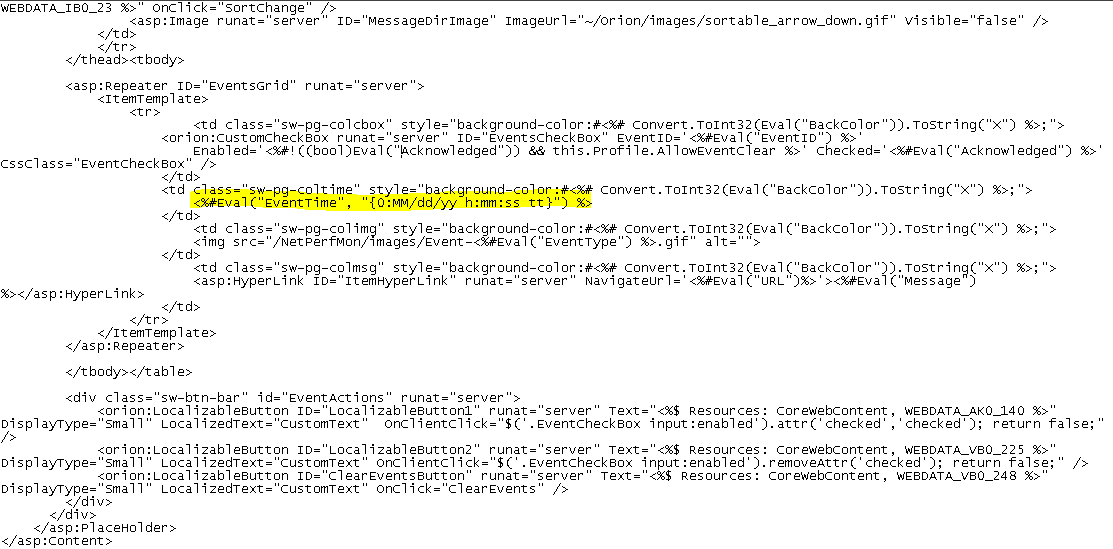

MAKE A BACKUP FIRST, JUST IN CASE. Then edit the "C:\inetpub\SolarWinds\Orion\NetPerfMon\Events.aspx" as described below.
BEFORE:
AFTER:
The snippet of code that needs editing is near the bottom, search for the phrase "EventTime". "{0:g}" should be changed to "{0:MM/dd/yy h:mm:ss tt}" as seen here:
