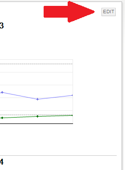

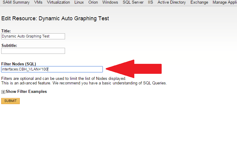

Now, I click the edit button on the resource, which takes me to the filter criteria page.
Use the normal filter syntax to narrow down the resource query.
In the example above, I am only going to show graphs for the "subinterface vlan 100" interfaces, using interface custom property "CBH_VLAN".
Now, after applying this filter, my list of 150+ interfaces/graphs, will be filtered down to only 50+ interfaces/graphs.

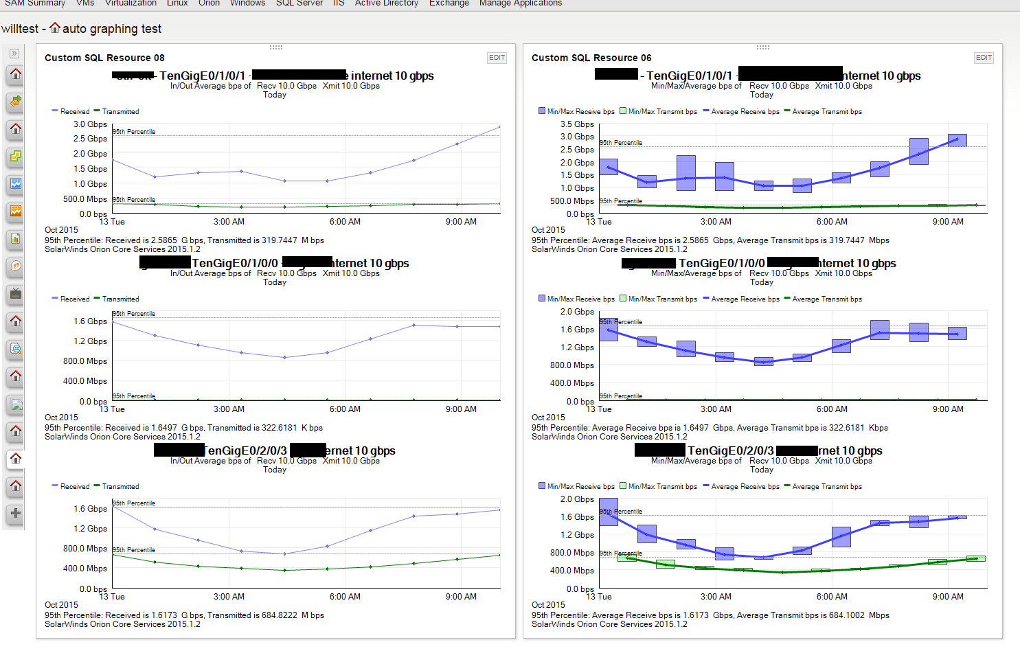

Now we can have a single page that has 3 tabs, and show 50 different graphs for 50 different interfaces across 50 different nodes... And all without having to setup anything other than a simple filter... taking only about 10 seconds.
(The picture below is using different filtering than the above examples, however, it should do well to provide a fairly decent visual... hopefully)
You can change the graph type by altering the part of the code towards the bottom of the file:
