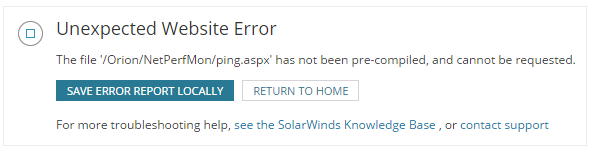

I was actually trying to get it working on the newest version, but it would through an error (screenshot above). ekis, are you observing same behaviour?
In reply to my own question - I did some further digging and realised that this particular error might have some fixes and workarounds. I haven't tried it yet, but once my next deployment is up an running (few month down the line) I will update this thread with solution for this particular problem

I had to copy the ping.aspx file into the correct directory. Then run the configuration wizard(just for the website option, and using the existing website). After the configuration wizard finishes then copy the ping.aspx file back in the directory and it worked for me. I'm using the NPM 12.0 version.
ou wow, this is awesome. I will try now...
would you please clarify what you mean by "correct directory"? And were exactly you kept it before and after wizard run
By "correct directory", I just meant that make sure that the file is somewhere that IIS can serve the ping.aspx webpage. I have mine under "Orion/NetPerfMon/ping.aspx".
So the process that worked for me is:
1. Copy the ping.aspx to the folder.
2. Run the configuration wizard. (Just the website option and using the existing website) (for emphasis, the ping.aspx has to be there when this is run.)
3. The wizard will delete the ping.aspx file.
4. Copy the ping.aspx back to the folder.
5. The page should now work.

2. Change "/inetpub/SolarWinds/PrecompiledApp.config" file as follows: (Copied from Prosperon)
Before: <precompiledApp version="2" updatable="false"/>
After: <precompiledApp version="2" updatable="true"/>

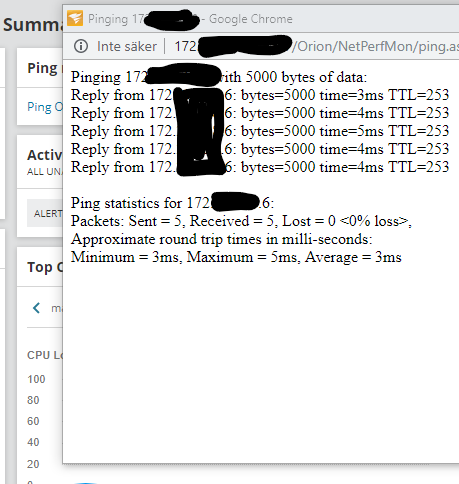

3. On the node page I added a Custom HTML component with this code:
<a href="">thwack.solarwinds.com/.../ping.aspx target="popup" onclick="window.open('/Orion/NetPerfMon/ping.aspx?IP=${IP_Address}','Ping ${IP_Address}','width=600,height=400')">Ping ${Caption} by IP: ${IP_Address}</a>
And I got this link that pops up a little new window with the "ping-info"

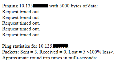

Any idea why it would fail to respond? If I ping from poller to server from command line, it works. But in the customized resource it times out:
from command line:
Rick
The ping will run on the web server, does it work from there?
To make it a bit stranger, it works on some node pages, but not others. Not sure why. This is an environment I didn't setup and tbh, I've never used this. The out of the box response time, etc seemed to good enough for icmp based data. Any idea why? Or where the setting is that this sends 5000 kb instead of the normal ping from cmd of 32 kb?
Looking at the code in the file ping.aspx i see:
byte[] data = new byte[5000];
So it's pinging with 5000 bytes, not 5000 kb.
When it does not work, what do you get then?

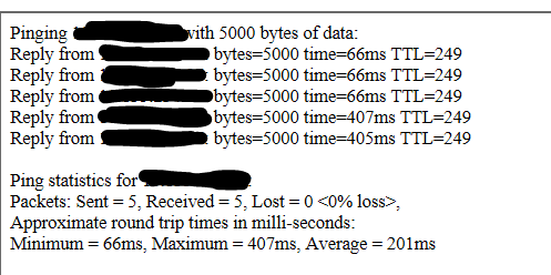

Quick update, it works on some of the nodes, but not others. I've made sure the one not working and is working are assigned to the same poller.
One that doesn't work:
The one on same poller that does work:
The are both:
