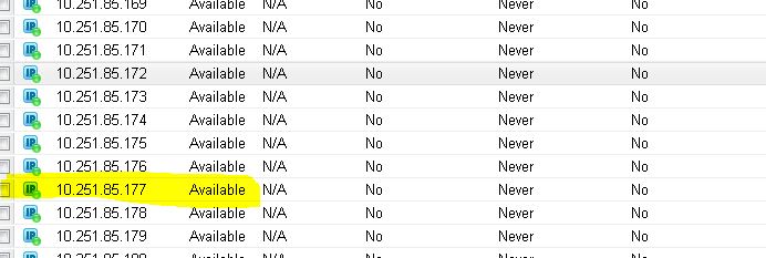

We have a question regarding our IPAM. We have noticed that it shows currently used IP addresses as being "available" when they aren't.

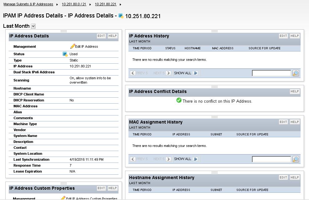

Adding pics for further clarification. Thanks!

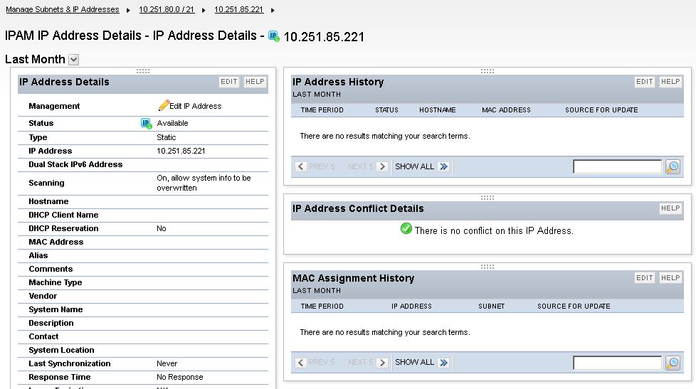

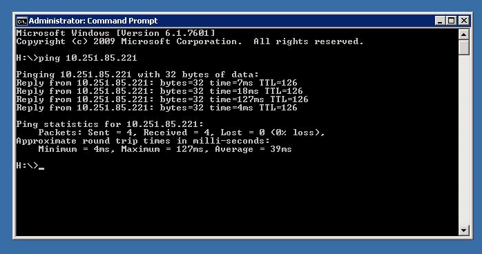

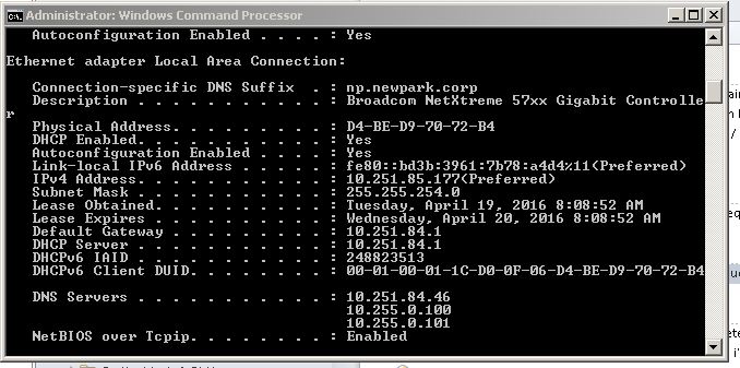

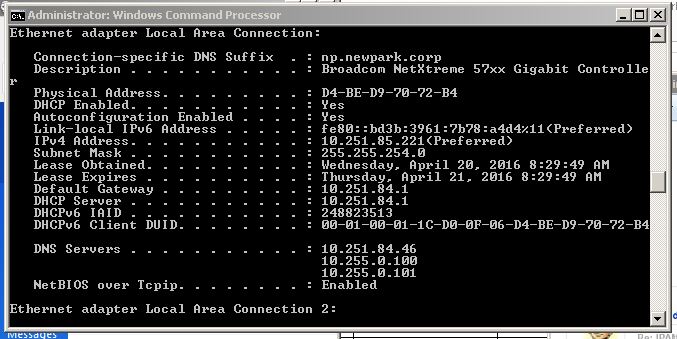

**Didn't think to try pinging this address from the IPAM server yesterday and now my PC has another address (10.251.85.221) and that one did show used this morning but now it shows available again. Can ping the 10.251.85.221 from the IPAM server while it is listed as available in IPAM.

Attaching some pics
The IP in your 2nd and 3rd screenshots are different. One of them is 80.221 and the second one is the correct one ending in 85.221

Hi, thanks for catching that and thanks for your reply.

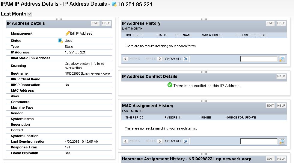

The correct is 85.221. We did just run a manual scan and now my IP shows as used although nothing shows in the IP history for this address. If that's all it is maybe our scan interval needs to be shorter.
Do you know when the IP Address History box would or would not show results? We have noticed some addresses show history results and some don't like this one.
