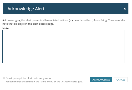

I'm using the out of the box "All active alerts" report but the AcknowledgedNote does not work, it's always blank. Is acknowledgedNote the comment you type when acknowledging an alert or is it someting else?
If you acknowledge an alert, does it disable all actions or only trigger actions?
