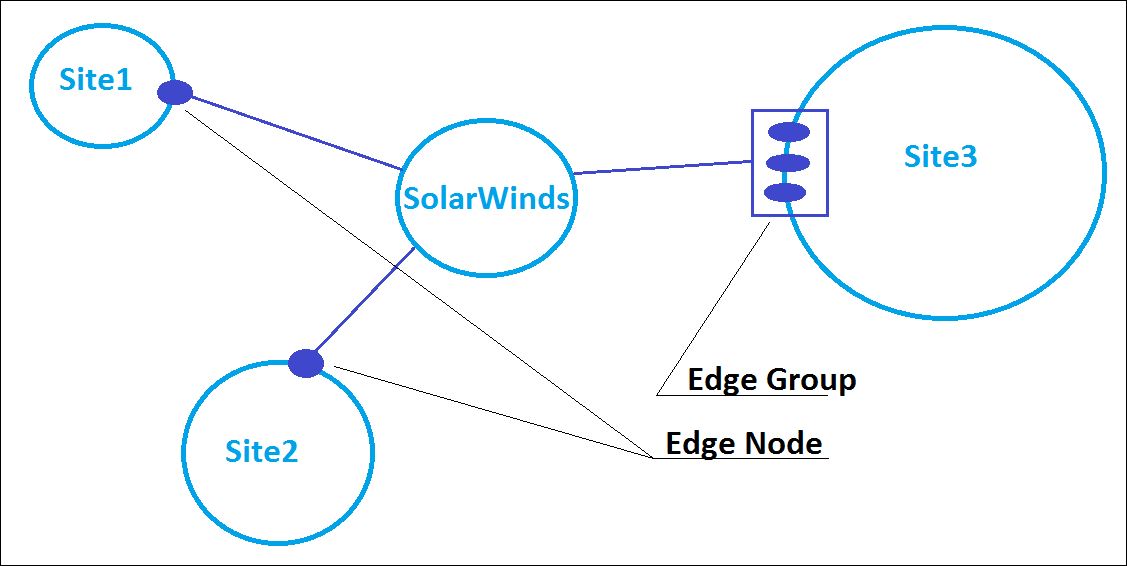

You will have table, which will hold all information about your sites + information about edge devices (or group of edge devices if you have HA routers/firewall on the edge) allocated to every site.
You we will then have magic happening at the background which will keep creating and managing all site dependencies for you the moment you change site for the node or update edge devices for any site

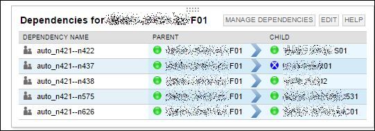

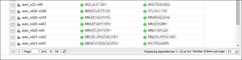

The result is pretty awesome. In my case 153 dependencies have been automatically created in a split of a second and now are being dynamically managed just by me maintaining node's site id custom property. Besides I really feel I am in full control over them all
Notice naming convention:
Names start with "auto_" for all dependencies created this way. In case you create some of your own manual dependencies they will not be overwritten nor will be deleted as long as you do not give your manually created dependencies "auto_" at the beginning of a name
Here is how it will look like on the Node's page when you will add resource "All Dependencies including node ${Caption}"

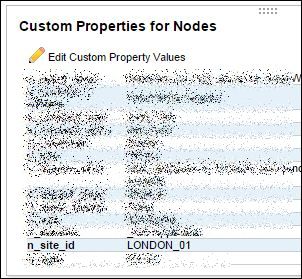

Third - you need "n_site_id" custom property which you will use to specify the location for the node. As described in my previous articles I do this with "n_site_id" custom property:

- EdgeNodeID is an ID of a node. When you land on the node page you can get this ID from the URL
- EdgeGroupID is an ID of a group. Group your edge devices together and then from the group summary page note down Group ID from the URL

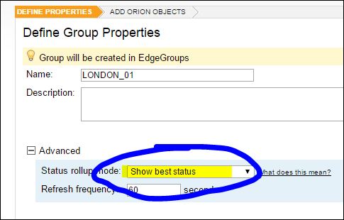

- Remember to set your group settings to roll over to down state only when all devices are down (screenshot below) - this is key when setting up dependencies for the group
