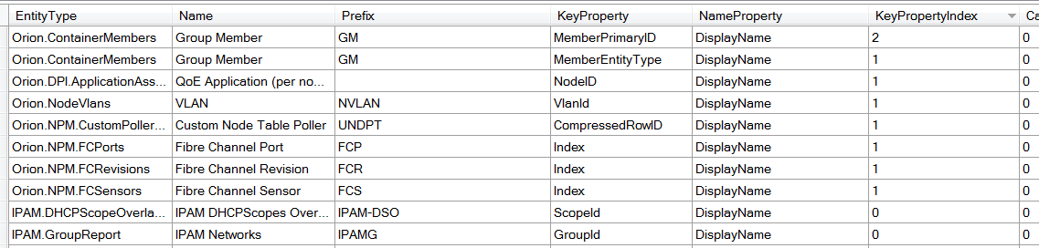

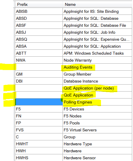

EDIT 1: Also noticed that the NetObjectTypes table has some blank Prefixes that still have a type associated with them. What's this all about:

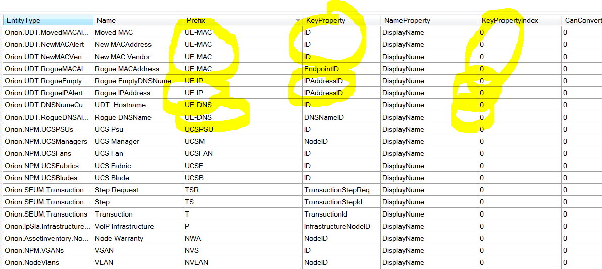

EDIT 2: Also just noticed that there are many duplicate prefixes with different Name matches. I'm sure that will cause a problem, but I wouldn't think it would be an "Unknown dataprovider type" error. Why are there either duplicate prefix/name combos, or duplicate prefixes mapping to different names? How does the program use these items and know how to map duplicate prefixes to the different Name fields?
Orion.NetObjectTypes
| PREFIX | NAME |
| AA | Application |
| AA | APM: Application |
| FCP | Fibre Channel Port |
| FCR | Fibre Channel Revision |
| FCS | Fibre Channel Sensor |
| GM | Group Member |
| GM | Group Member |
| GM | Group Member |
| IPAMN | IPAM Nodes |
| IPAMN | IPAM IPAddress Conflict |
| NVLAN | VLAN |
| NVLAN | VLAN |
| UE-DNS | Rogue DNSName |
| UE-DNS | UDT: Hostname |
| UE-IP | Rogue EmptyDNSName |
| UE-IP | Rogue IPAddress |
| UE-MAC | New MAC Vendor |
| UE-MAC | Moved MAC |
| UE-MAC | New MACAddress |
| UE-MAC | Rogue MACAddress |
| UNDPT | Custom Node Table Poller |
