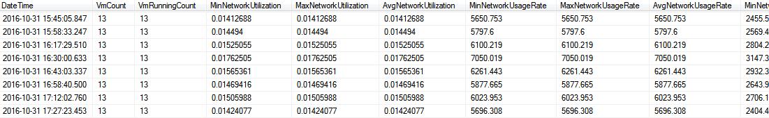

Here is the view of the data from the CPULoad_Detail table:

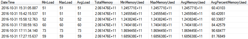

And here is the same time interval from the VIM_HostStatistics_Detail table
