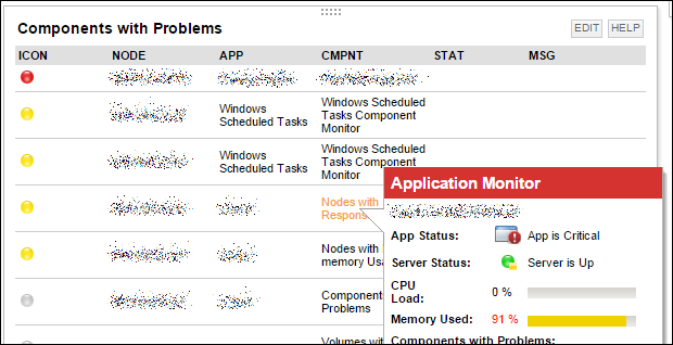

- Display your components with problems along-side with nodes, apps, message, etc in one SQL report
- Direct click-able links for the objects
- Status icons
- Use this report as a resource on the page

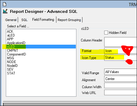

* For the URLs to work you would need to copy paste URLs (which you can find in the SQL script below as green comments, next to columns descriptions) into Web URL field of the Orion Report Writer, under Field Formatting tab. You can also hide ID fields as they are only used to build URLs). If you will download attached Report - this is all has been done for you already

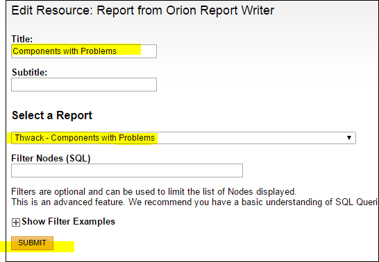

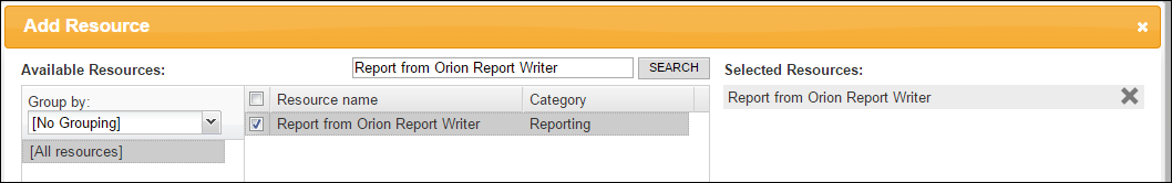

Once you have configured and saved you report in Report Writer (or you can download attached) - you can then add "Report from Orion Writer" resource to any page you like (usually it would be your summary or NOC page)
Select this new report from the resource:
You are done!
