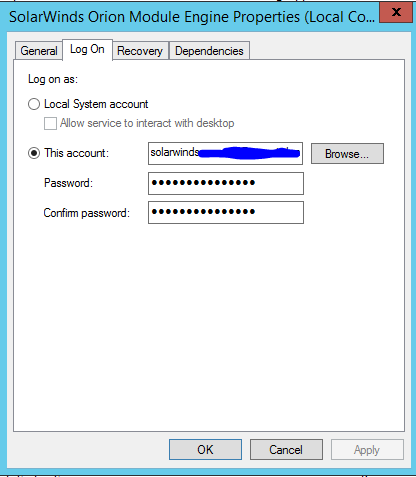

SolarWinds Orion Module Engine Windows Service Fix
In order to run PowerShell scripts from executed alerts, you must modify the Windows service on your primary poller. Change the "SolarWinds Orion Module Engine" service from running as Local System, to the Windows account used for polling. When completed cycle the SolarWinds services, (a reboot may be required for this to take affect. I do not recall).
