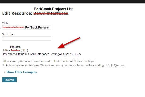

Step 1: Customize a page, adding the "Custom Query" resource, then edit said resource.
Step 2: Copy and paste the SWQL query below, into the resource.

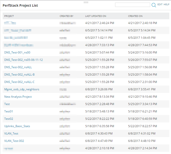

This simple SWQL query will generate a list of all PerfStack projects, with clickable links, taking you directly to the project.

Step 3: View, search, sort, and click through your simple little list of PerfStack projects.
